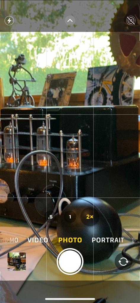

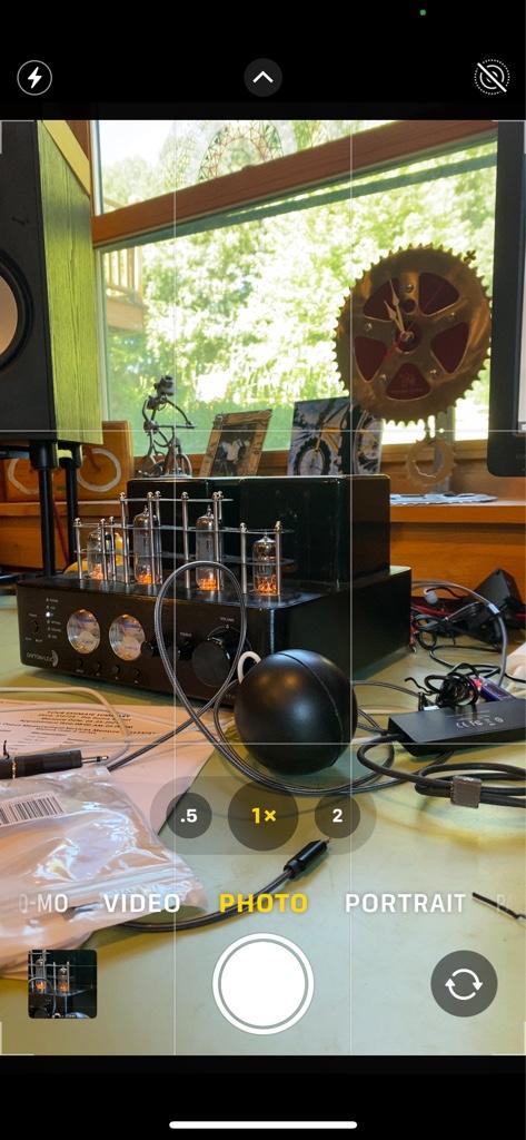

placeholder for photos ...taken at various optical and zoom on my iPhone 11 (3 optical lens, 0.5, 1.0, 2.0)

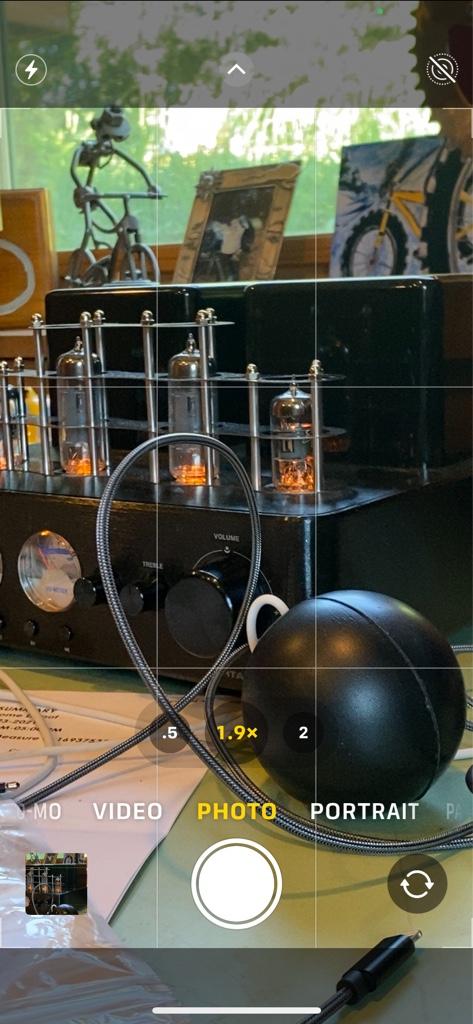

If you desire pure optical , no digital interpolation, then only hit one of the 3 and you will be “pure” thru the lens to sensor. If you “pinch” to zoom in / out the phone selects lens and interpolates the pixels.
Will need to pixel peep on my 27” iMac to see if there’s anything to notice .. and also like on a DSLR where a wide lens, std lens, zoom lens gives different “look” to a same scene
I pinched in on 2x and the phone selected 1x lens at 1.9x setting , that’s apple’s algorithm

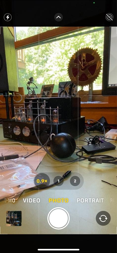

Same here, at 1 lens then pinched in, phone switched to 0.9x, as such it might give a different look as it’s going thru 0.5 lens then scaling up , vs near same 1 lens

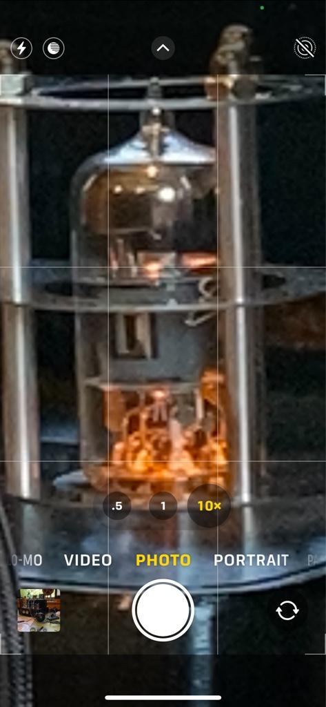

And just for fun, went 10x .. tube amp
