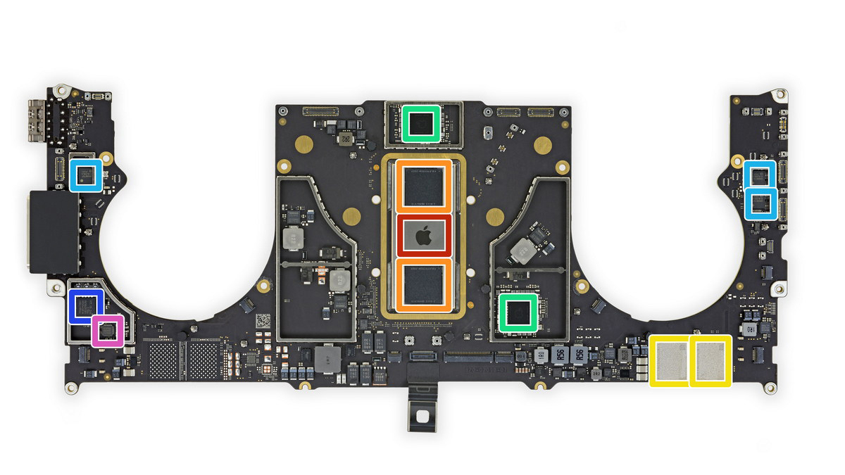

The iFixit teardown of the base 14" MBP M1 Pro 512 shows 4x Kioxia KICM225UZ0460 128 GB NAND Flash Memory: 2 on main board side 1 and 2 on main board side 2 with PCIe 4.0 interface.

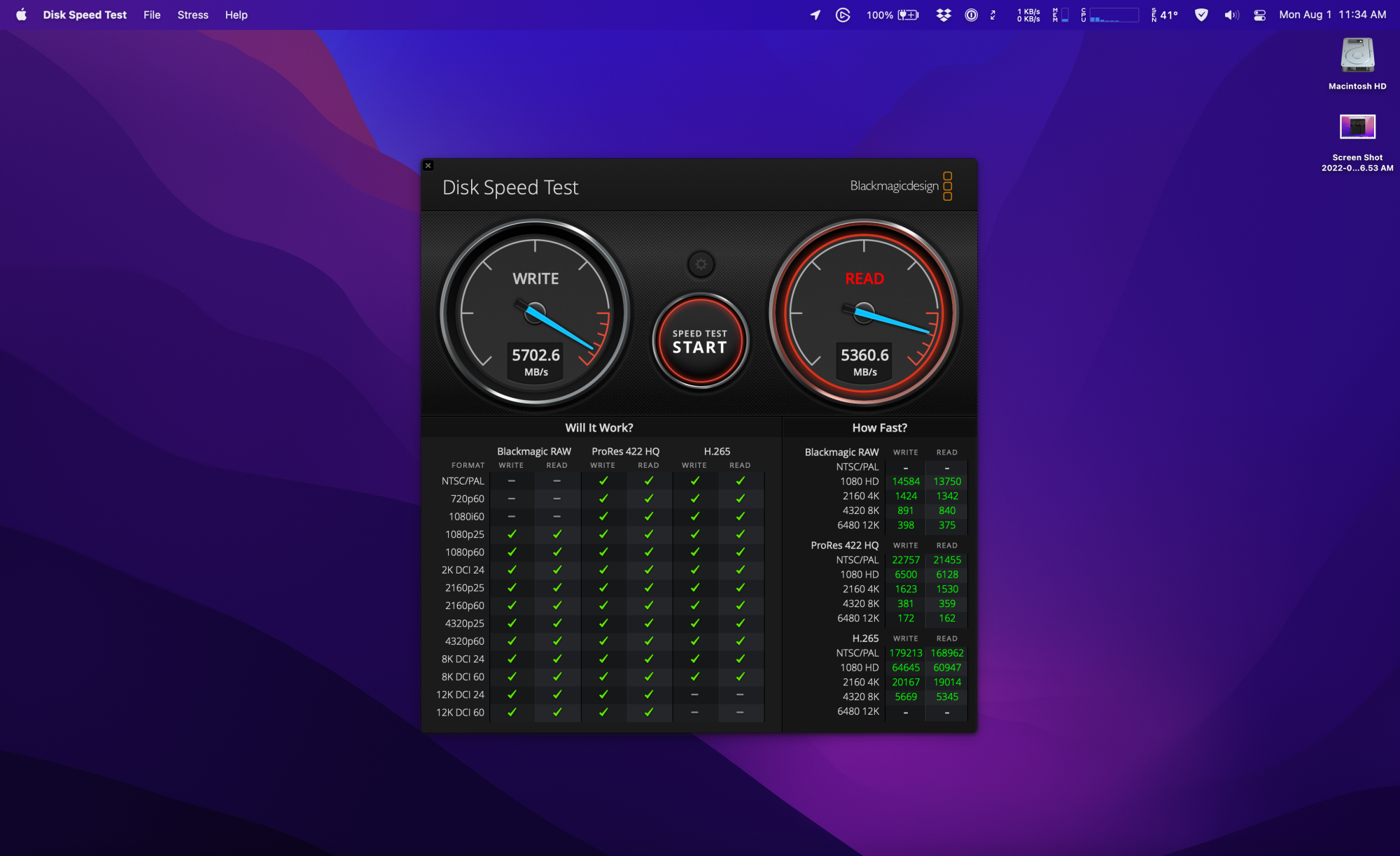

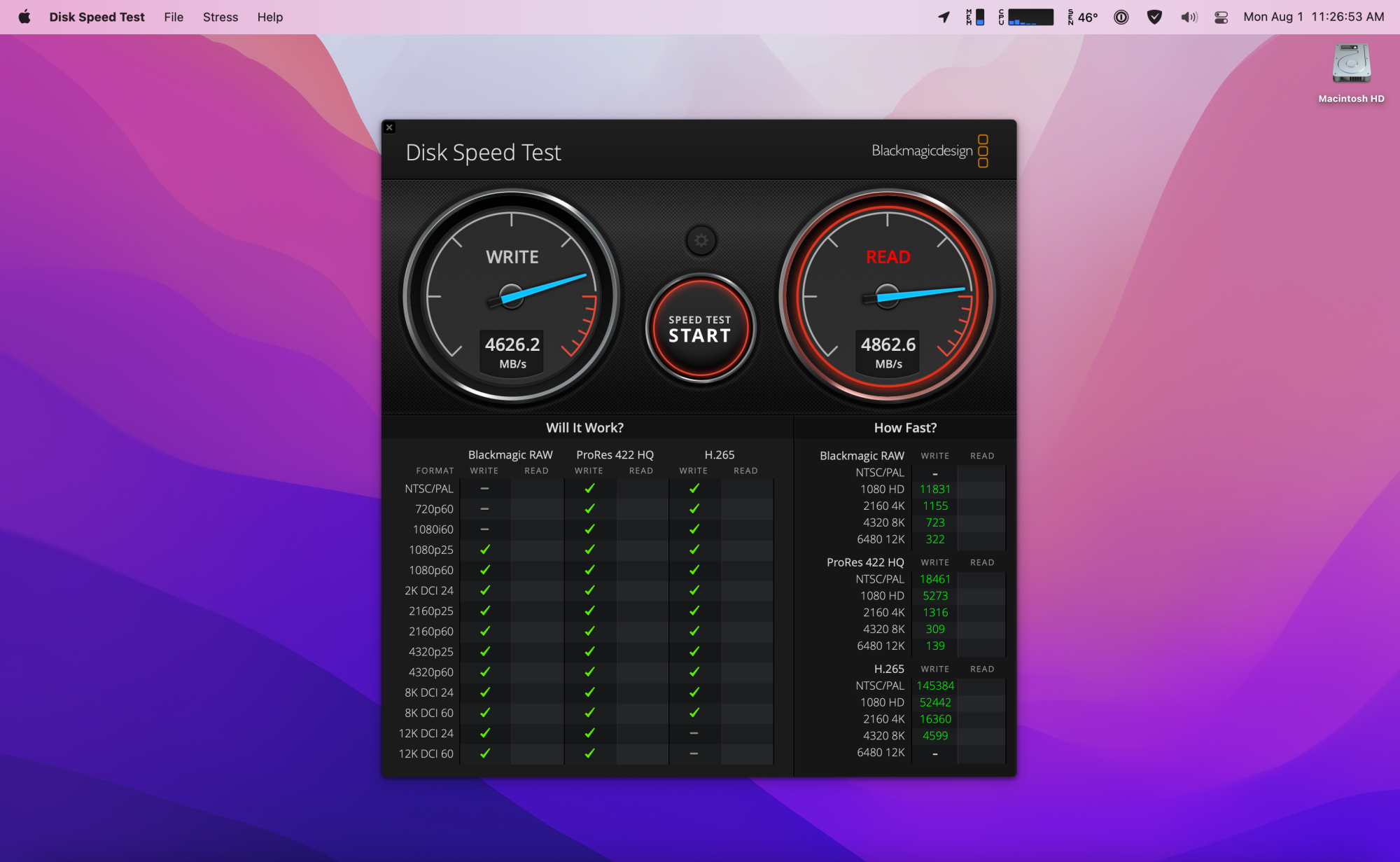

I own both the base 14" M1 Pro 16/512 and 16" M1 MAX 32/1TB
My 14" M1 Pro 16/512 SSD performance
and 16" M1 Pro 32/1TB SSD performance

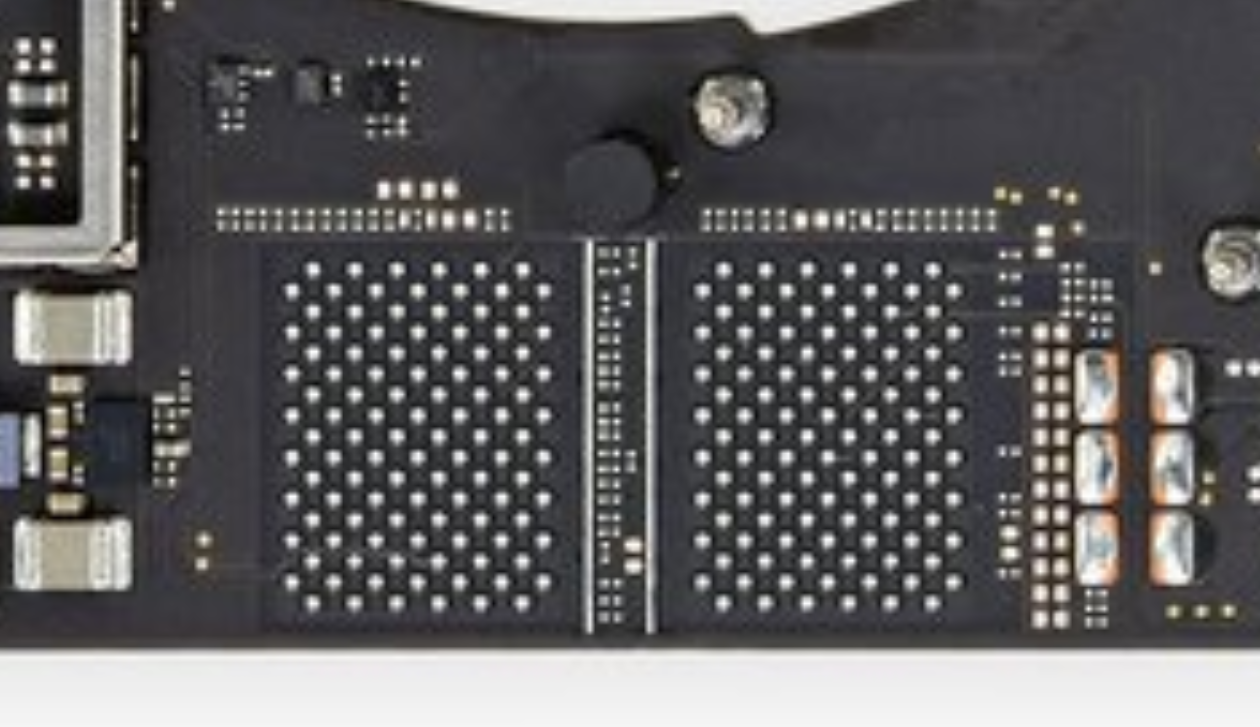

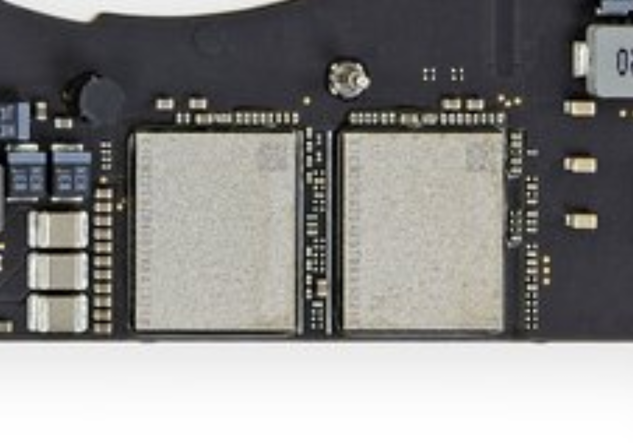

It uses 4 Kioxia (known as Toshiba in old times) KICM225UZ0460 NAND Flash Memory for 512 (in Yellow, same goes for the other side of the board) , and will use 8 of it for 1TB. There are 4 empty unsoldered spots on the board. (two next to the violet rectangle, and another two under it)
Closer looks of the NAND and the empty slots. Believe it or not, you can add an extra after purchase. It will cost you around $300 for another 512GB

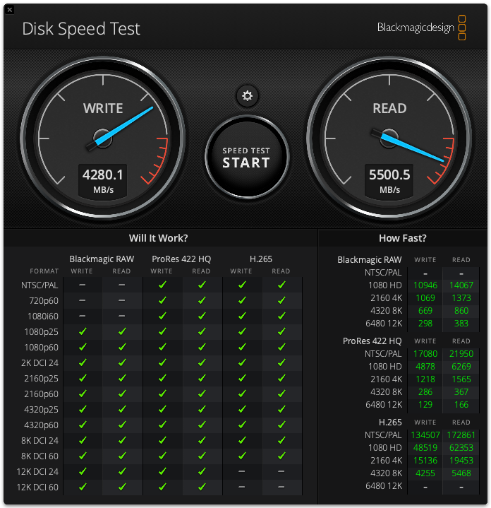

Let me download Black Magic. I have the 1 TB.
