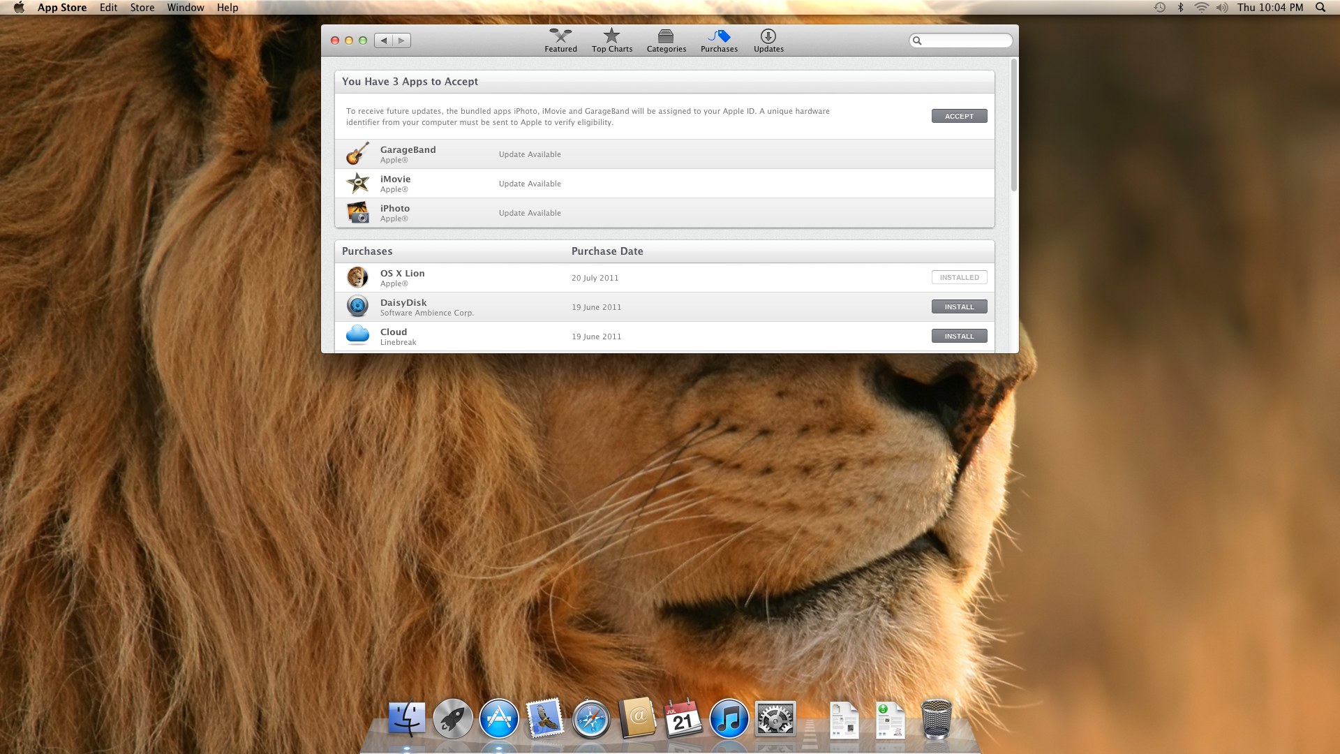

You need to 'Accept' iLife apps in App Store
Does the internet recovery download iLife too?
When you next load the App Store, the Purchases section shows the iLife apps (iMovie, iPhoto, Garageband) under Apps to Accept.
It then associates those apps with the hardware UUID of your machine. Once accepted, they appear just as other purchased apps and you can choose whether or not to download them.
