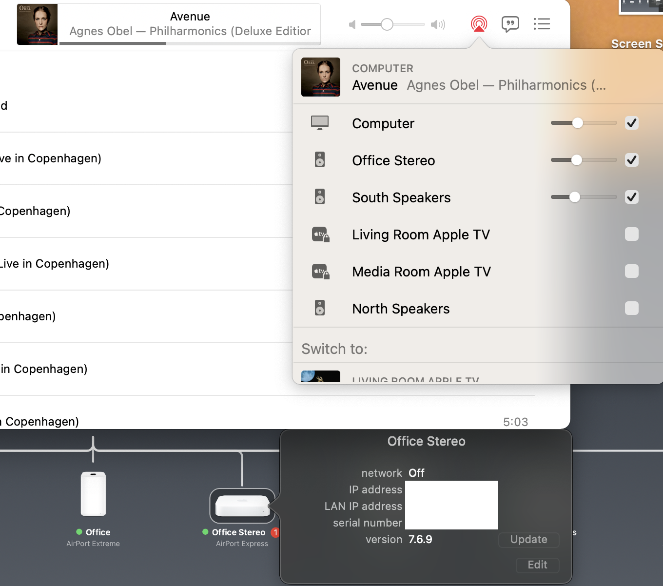

I have a few A1392 Airport Express units which I bought used to get multi-room simultaneous audio support. I updated them all to 7.8.1 immediately when I received them. In my home office I play from iMac to the AE at the stereo for background music, but when manually switching tracks I often get a split second crackle and then it plays fine after that. As long as I don't manually switch to another track I don't get the crackle. It only happens when I switch it myself in the iMac's Music app. I tried analogue, and it's still there, not just over optical.
I read online this was introduced at 7.8 and not fixed in 7.8.1 and that downgrading to 7.6.9 fixes this. So, I decided to give up multi-room to get rid of the crackle and guess what? The crackle is gone AND simultaneous multi-room still works. I had thought this latter feature was restricted to AirPlay 2, no?
Note that the "Office Stereo" has a red notification, which means it has an available firmware update, because it's now on 7.6.9, but you can also see that it's playing simultaneously with another 7.8.1 AirPort Express (South Speakers) and with my iMac (Computer).
So far so good. I haven't heard the crackle anymore. If it makes any difference, my iMac is on Big Sur. The other difference is at east with my Computer and Office Stereo, with this setup there is no instance so far where the audio has gone out of sync. That's happened before when Office Stereo was on 7.8.1. Also, I had the old A1084 AirPort Express and I could definitely not do multi-room with those. I could only select them individually from the Music application.

This may be old news to some of you. According to that reddit thread, if you play from iTunes (or Music), it was mentioned by one member that multi-room audio already worked fine on recent AirPort Expresses with AirPlay 1. However, I had tried this with my original A1084 AirPort Express units and it simply didn't work. The Music application never let me choose more than one of them at a time. However, I had never tried this with my last gen A1392 AirPort Express units with older firmwares. As mentioned, I had immediately updated the firmware when I received them.
I've been doing more testing and I can confirm the multi-room audio support with the 7.6.9 AE only works with the iMac's Music app. If I try to do this from iOS 14, it doesn't work. The other 7.8.1 AE units will play together simultaneously, but won't work with this 7.6.9 AE. When I choose that 7.6.9 AE, it shuts off the other AE units.
So, I guess the advantage of AirPlay 2 is not that it supports simultaneous multi-room audio. It's that it supports simultaneous multi-room audio when you are playing from a mobile iOS/iPadOS device.

tl;dr:
AirPlay 1: With some hardware it already supports multi-room simultaneous audio, but only if you play from a Mac. No crackles. Audio sync seems to work well. This doesn't work from an iOS device however.
AirPlay 2: You can have multi-room simultaneous audio, even from an iOS device, but you may get audio glitches when starting a track (at least in my case from my Mac). Audio sync may be problematic.
