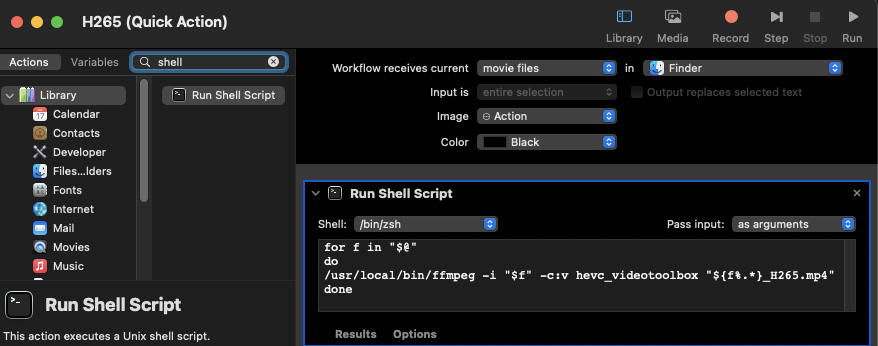

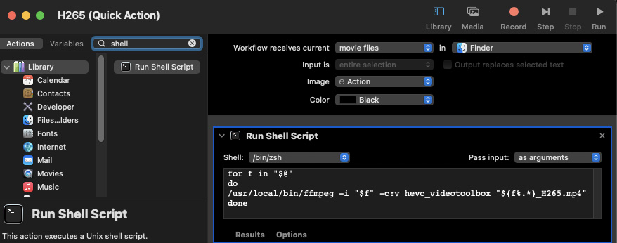

It’s not that complicated:
1. Download FFmpeg for macOS Apple Silicon from here https://www.osxexperts.net
At the moment, it’s FFmpeg511ARM.zip
https://www.osxexperts.net/FFmpeg511ARM.zip
MD5 2ed7c86ad42f5f11e49c6c5ff26120f8
SHA-1 8304877e4ec59d7d777153c5bdb9dc1aa901aa1f
SHA-256 289d2ffb60a8dbbd7c0df0ac1daac191fbe7fa02fb256b05a044018d75d10753
VirusTotal link https://www.virustotal.com/gui/file/289d2ffb60a8dbbd7c0df0ac1daac191fbe7fa02fb256b05a044018d75d10753
2. Unzip FFmpeg511ARM.zip and move the ffmpeg binary into /usr/local/bin/
From Terminal, just one command
Code:
sudo unzip ~/Downloads/FFmpeg511ARM.zip -d /usr/local/bin/
3. Create a new Quick Action with Automator
https://support.apple.com/guide/automator/use-quick-action-workflows-aut73234890a/mac
select Workflow receives – movie files in Finder
add Run Shell Script with the following code
Code:
for f in "$@"
do
/usr/local/bin/ffmpeg -i "$f" -c:v hevc_videotoolbox "${f%.*}_H265.mp4"
done
Save the quick action as H265 or any name you want, go to Finder, right-click on a AVI file and choose H265. Using ffmpeg, the selected video file would be converted using hevc_videotoolbox, with _H265.mp4 added at the end of the name.

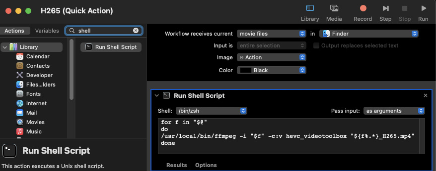

Thank you! This is what I was looking for. I successfully created the Quick Action but get a 9-page error when I run it on an MKV file. This is the last part of the error:
Stream mapping:
Stream #0:0 -> #0:0 (h264 (native) -> hevc (hevc_videotoolbox))
Stream #0:1 -> #0:1 (aac (native) -> aac (native))
Press [q] to stop, [?] for help
[hevc_videotoolbox @ 0x7f9527f05280] Error encoding frame: -12905
[hevc_videotoolbox @ 0x7f9527f05280] popping: -542398533
Error initializing output stream 0:0 -- Error while opening encoder for output stream #0:0 - maybe incorrect parameters such as bit_rate, rate, width or height
[aac @ 0x7f9527f06700] Qavg: 65536.000
[aac @ 0x7f9527f06700] 2 frames left in the queue on closing
Conversion failed!”
