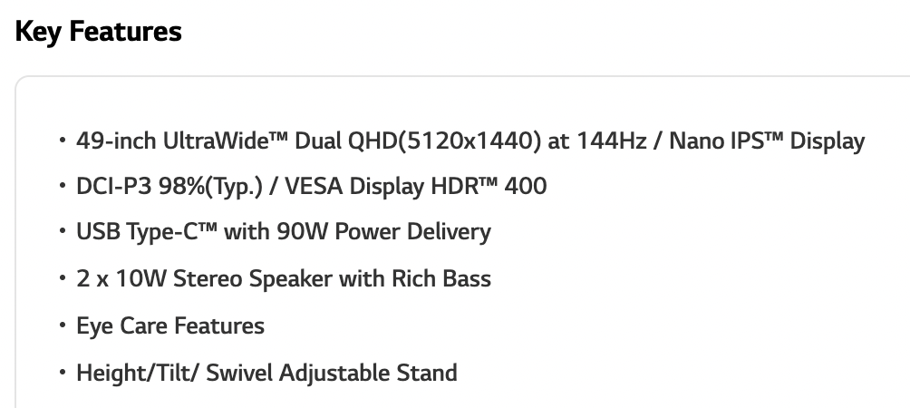

I want to run 2x 49WQ95C-W which has a resolution of 5120x1440
