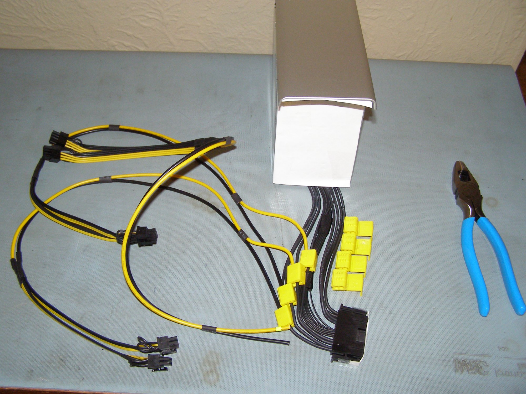

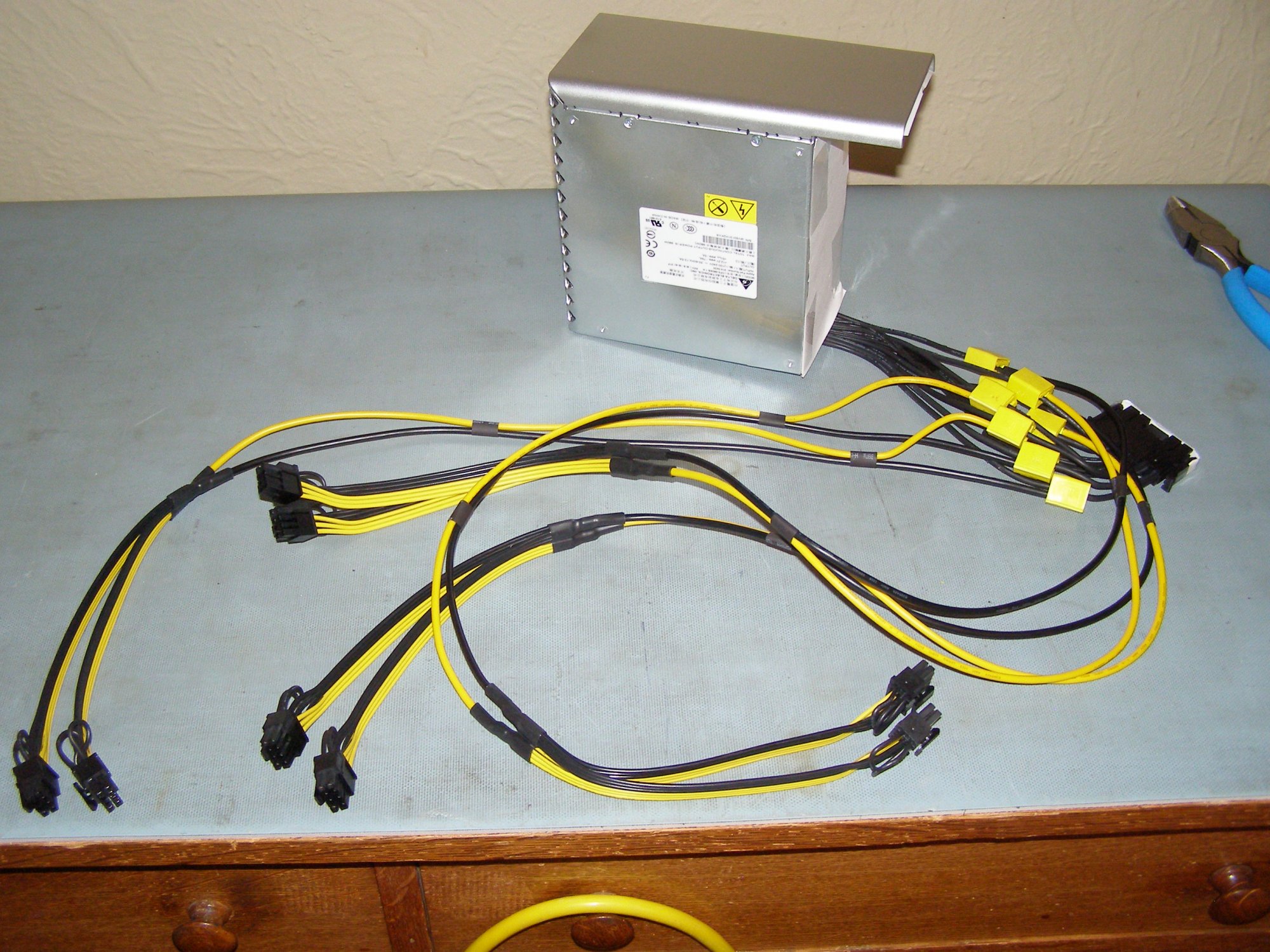

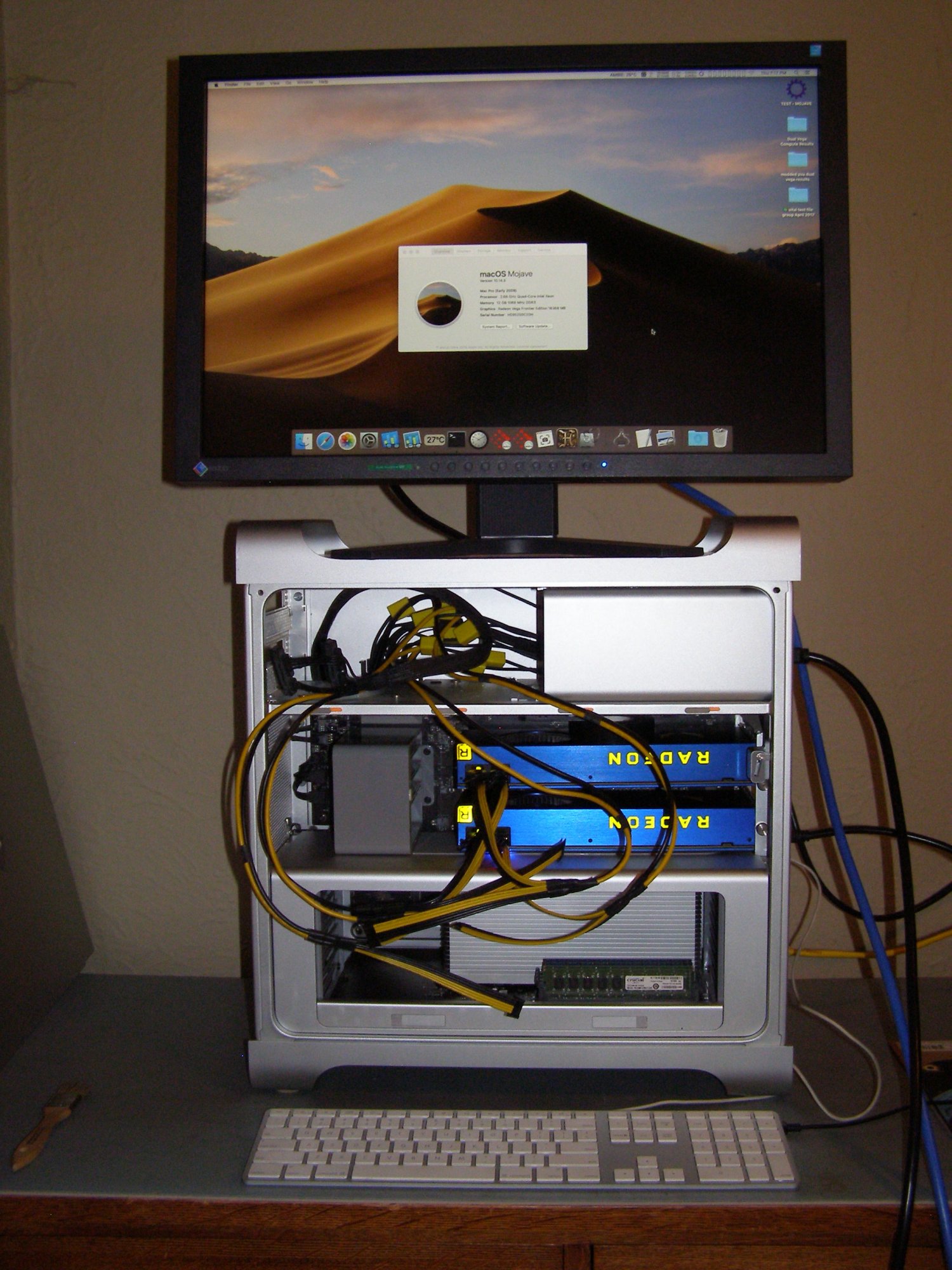

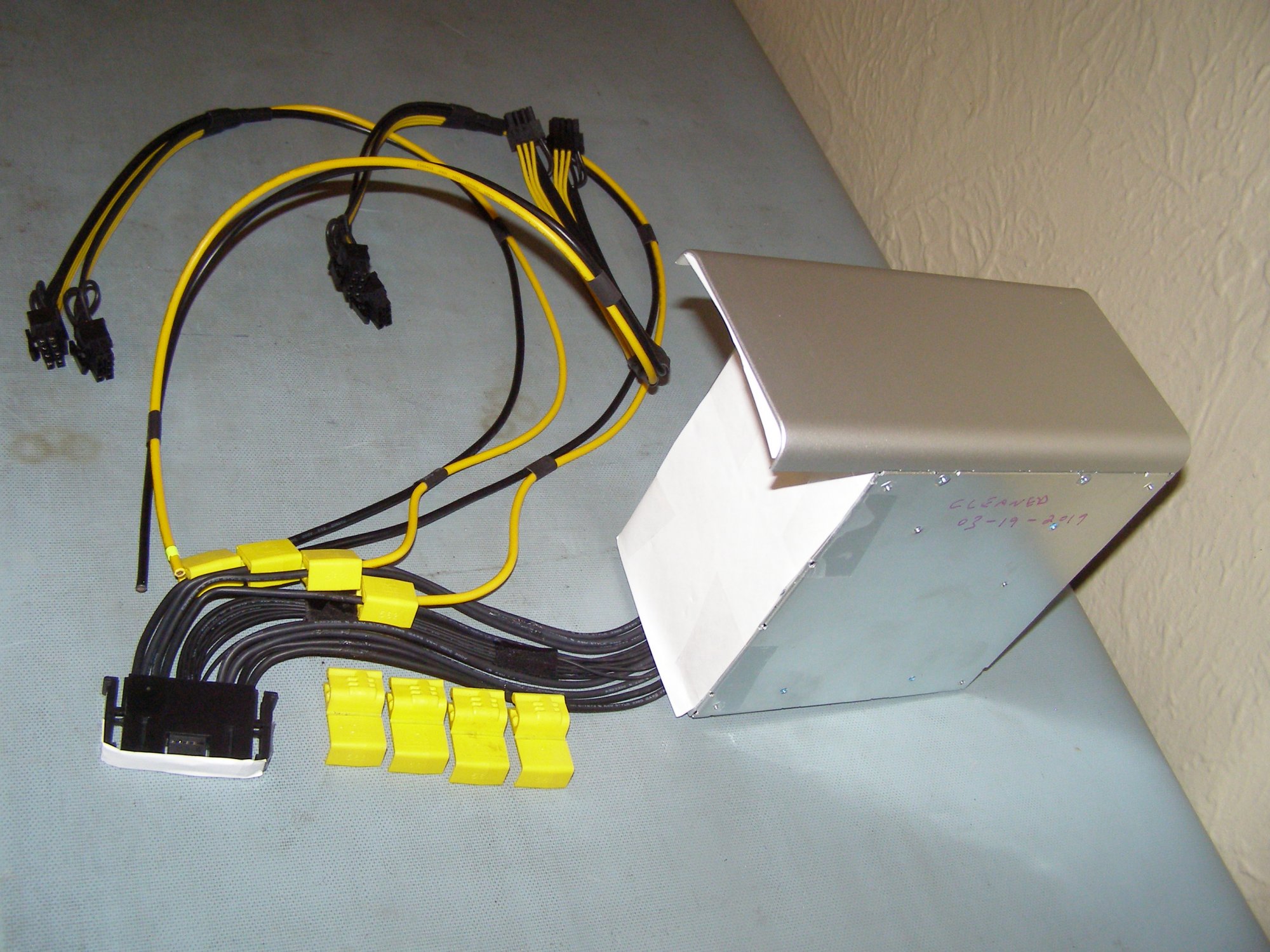

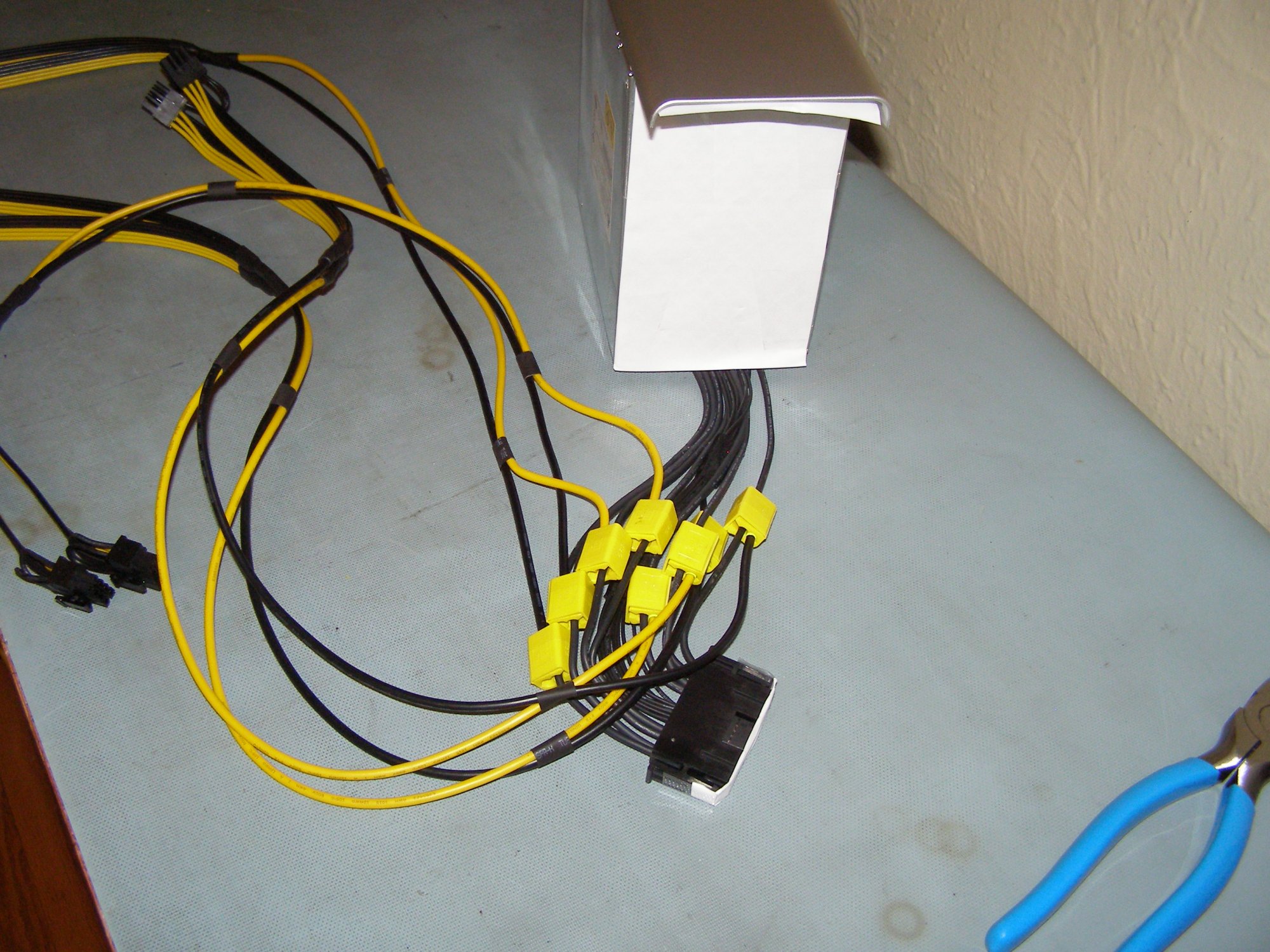

Modified Pixlas mod with quad 8 pin ( 150 W ) PCIe booster power cables to the dual 300W class GPU .
Dual Vega Frontier Editions all internally mounted and powered . Yes , its stable . Excess cables need a little trimming ... but its amazing what the factory PSU is capable of .
The Dual Vegas pulled around 660 W all by themselves at load . Bandwidth is better than using an external expansion chassis with the same cards .
Nice thing about this mod is the side access panel can be properly secured and the Mac looks quite spiffy and professional . Unless you looked closely , you'd never guess the power under the hood .
Something just occurred to me ... what do you call a modded mod ?
[automerge]1579376547[/automerge]

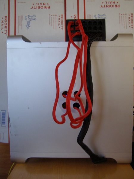

Or if you're dynamite with a power drill , aluminum side access doors just love this mod .
The external PSU is a 1000W EVGA ATX with lots of 8 pin PCIe booster power connections .
This does the same thing as the above , but takes less skill , should last longer , guaranteed to bedazzle clients in attendance and is not that expensive .
Just make certain that external PSU always provides juice to the booster cables before your Mac starts up .

I finally found a few pictures of the quad 8 pin PCIe booster power mod of a Nehalem cMP PSU , that I made for the Dual Vega F.E. configuration ( post number 8 of this thread ) . This mod will push two 300 W class GPUs in a cMP . Build this at your own risk as it really will provide 600 W ( 4 x 150 W ) worth of juice . I was always worried it'd burn out or catch fire , but it was always reliable and safe during my tests .

BENEFITS BEYOND THE OBVIOUS
(1) You can now power your 'Dual Radeon VII' GPUs with enough headroom to power a 3rd GPU (because.. cMP 5,1 PSU + NA211A PSU = cMP 7,1 PSU)
(2) In the strictly defined "5 PCIe cards (7 high)" config, my 'recommended' PCIe card slot placement is deliberate and improves upon your initial thinking in subtle but important ways. The DT130 *must* be in SLOT 2 - it will use (saturate) 8 of the 16 lanes at every opportunity it gets. The GPU will typically use (dynamically negotiate a link speed requiring..) between 1 and 4 lanes of bandwidth 364 days a year**. Similarly, putting the Netstor HOST Card (PCIe 2.0 x4) in SLOT 2 - will never use more than 4 of the 16 available lanes.
(3) PCI-e cards installed at positions 3 and 4 are both single-slot form factor.
By installing the single-slot 'Netstor NA211A PCIe HOST Card', the 2nd double-width Radeon VII GPU can be safely installed in the Turbobox (NA211A) and the potential problem of installing "4x 6TB 3.5in SATA HDDs in RAID 10" in SATA Bays 1 - 4) is magically resolved.
This approach also means that, creatively "retro-fitting" messy external devices in order to compensate for weak spots in the build becomes WHOLLY unnecessary (i.e. extra GPU power supply, bulky 4-bay storage enclosure for 3.5in HDDs).
(4) Sonnet USB3 Card hosted in NA211A Turbobox provides 4 additional [extra-fast] USB ports up to 1.5m from the where the cMP is positioned.
