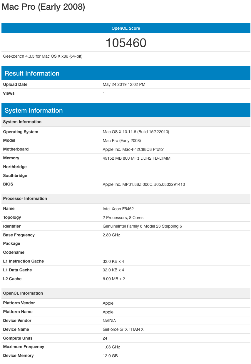

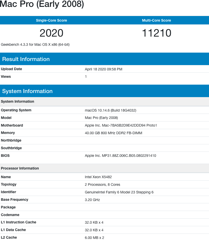

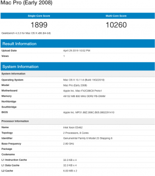

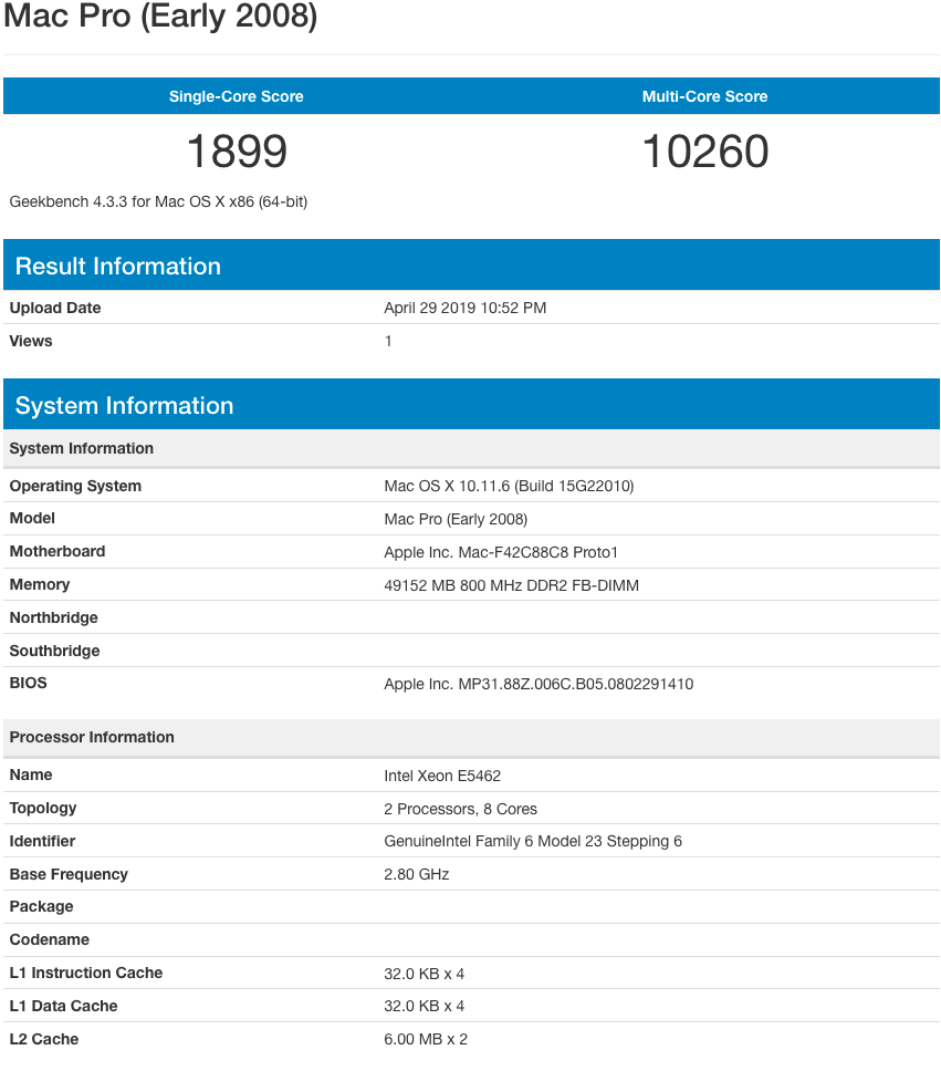

I really started updating my mine (2 x 2.8) about a year ago and did a Geekbench test at the time as a baseline:

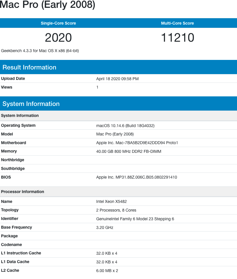

Benchmarking today (2 x 3.2), I get:
Basically about 6.3% more on Single Core and 9.2% on Multi Core. Not a huge jump.
I've had to pull two failed RAM sticks and this probably had some impact. Will test again when these are replaced.

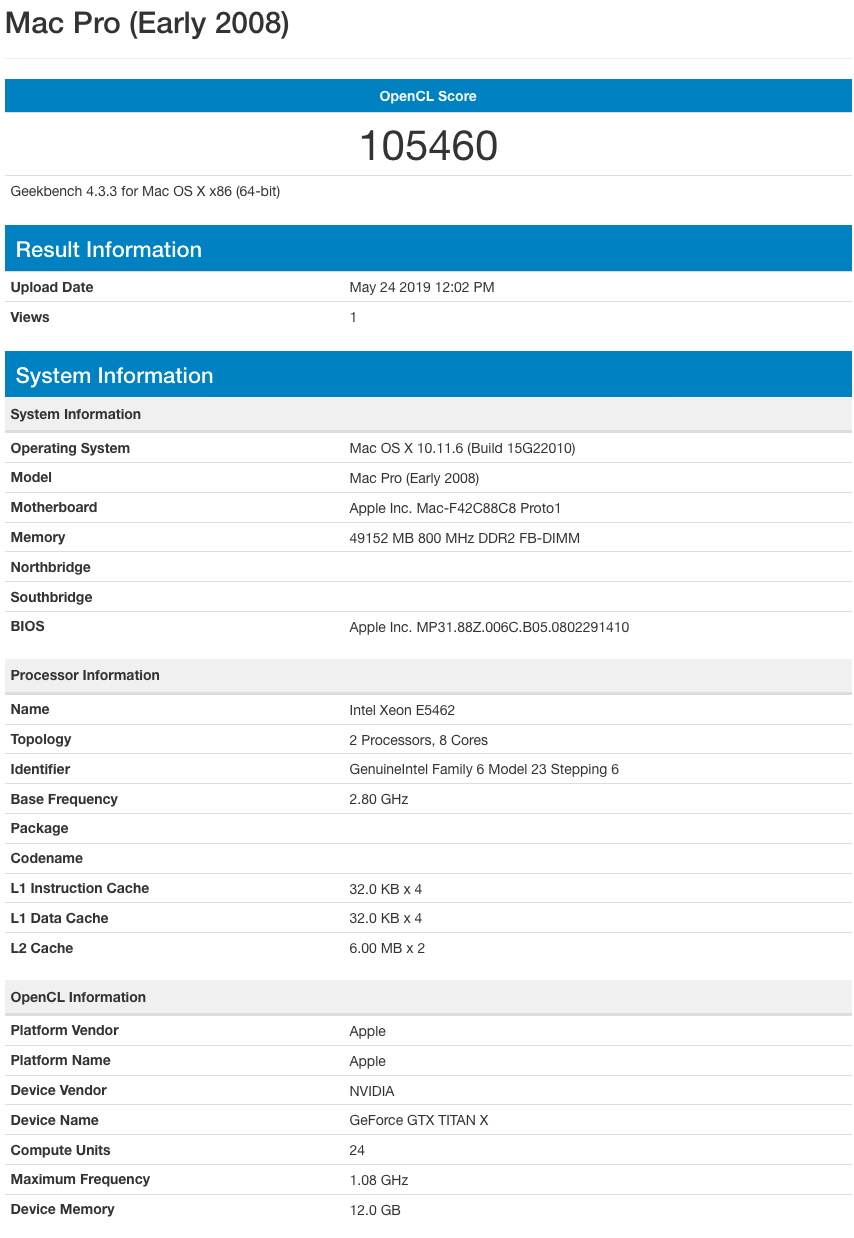

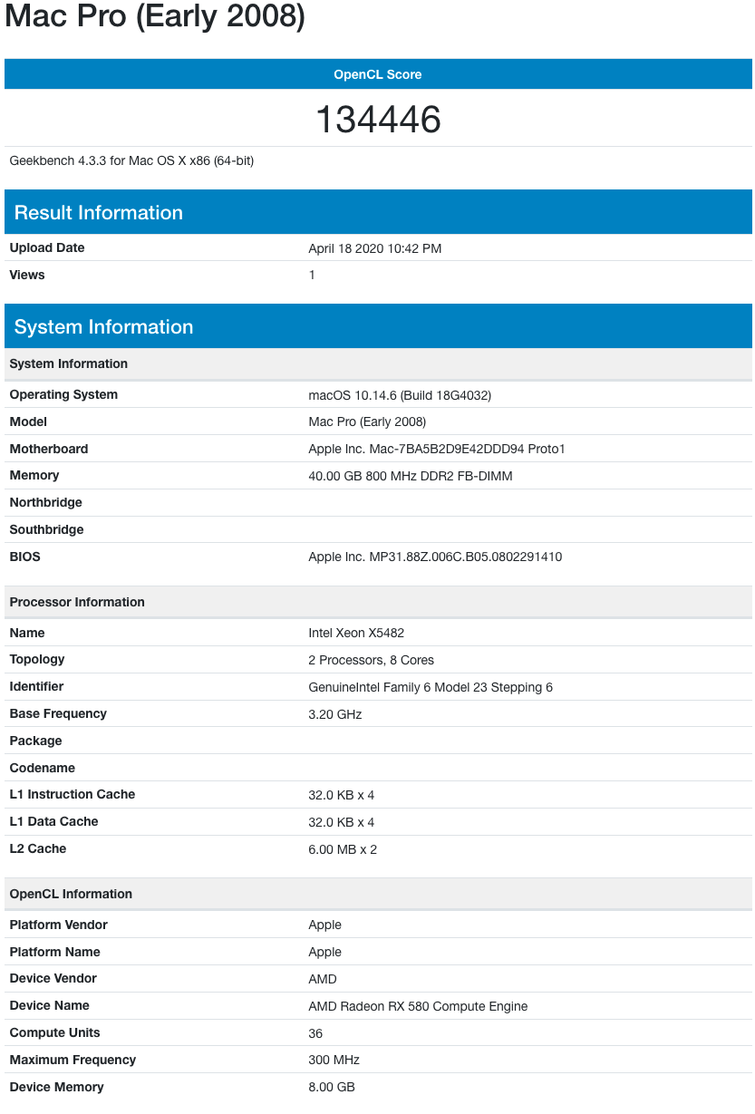

I had already upgraded my GPU from a HD 5770 to a Titan X last year when I took the baseline:

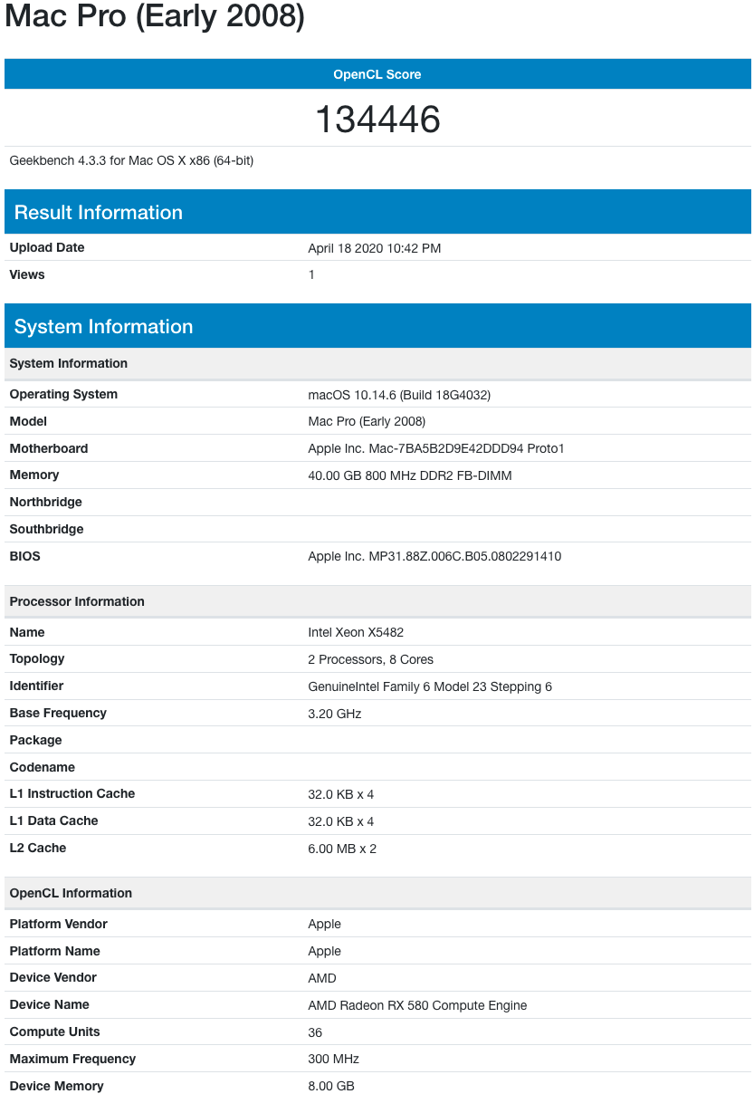

Benchmarking today (RX580) I get:
27.5% higher. Note that the RX580 results reflects hardware acceleration via OpenCore and the RadeonBoost Kext.

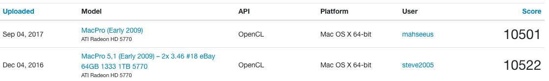

Where I would have been (roughly) with my old HD5770:

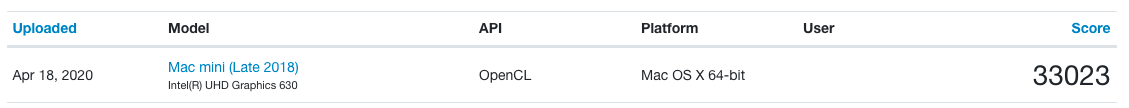

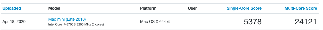

What I have found is that the CPU scores are really low compared to modern units. 2018 MacMini kills it for instance:
On the other hand, being able to use modern GPU's swings things the other way with those by order of magnitude:
The GPU numbers are on par with modern units in general.

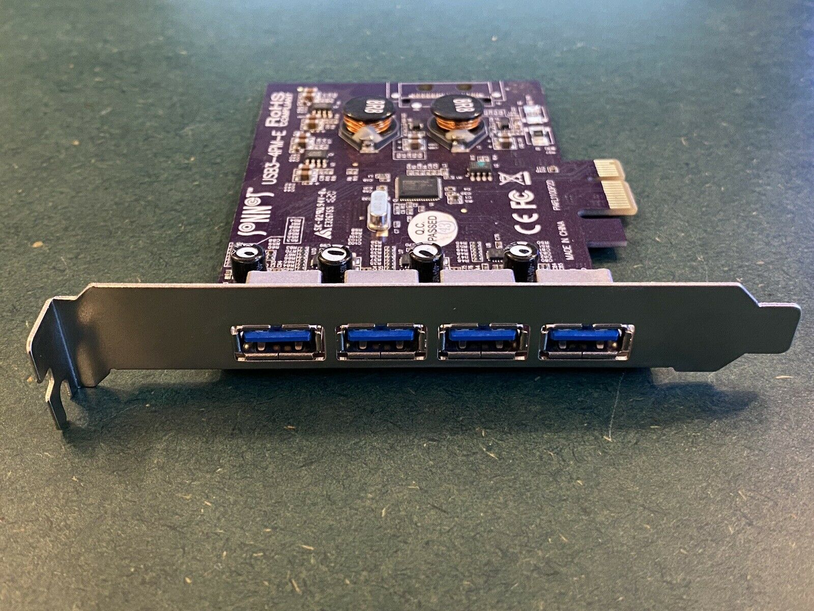

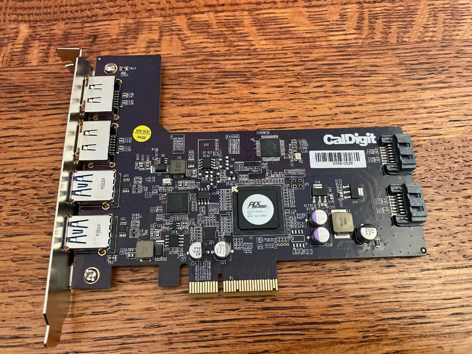

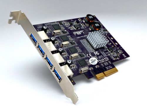

You’re Welcome. I’m using various brands of USB 3.0 PCIe cards like Sonnet Allegro Pro, Sonnet Allegro non-Pro model, Caldigit Fasta-6gu3 6g eSATA & usb 3.0 , Highpoint Rocketu 1144CM, Inateck. They all worked fine. If you’re getting a Caldigit card, just take note that the first gen model released in 2014 will only work up to OS Mavericks. This model won’t work in Yosemite and newer OS versions. The newer Caldigit card works from Mountain Lion to the latest OS
Sonnet Allegro Pro USB 3.0 Comes with the White Heatsink in the middle section
Sonnet Allegro Non-Pro Model
Caldigit 2ND Gen Model - Works from Mountain Lion to Mojave

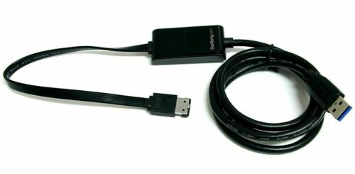

I have an External HD with an eSATA Port, I got a cable adapter that connects the eSATA port to the USB 3.0 port of the PCIe card
