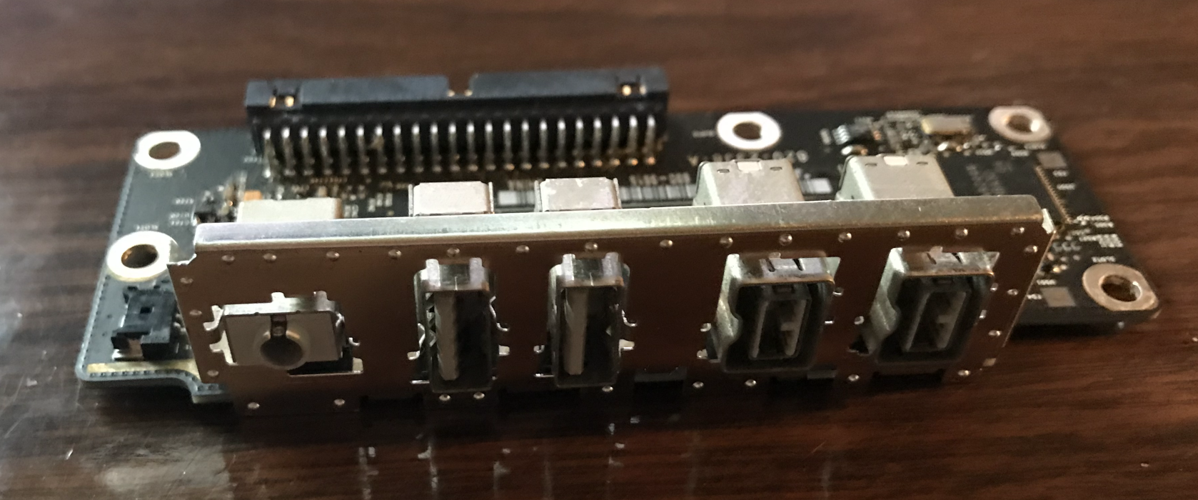

So I have replaced everything but the DVD drive (and the CPU tray although I tried another, working one which I would think should be compatible). When I bought this new Logic board the guy included the rear USB panel and I did not install it....thinking it was unlikely to be the problem:
I'm not sure if I need a repair or an exorcism. Any suggestions would be greatly appreciated.
