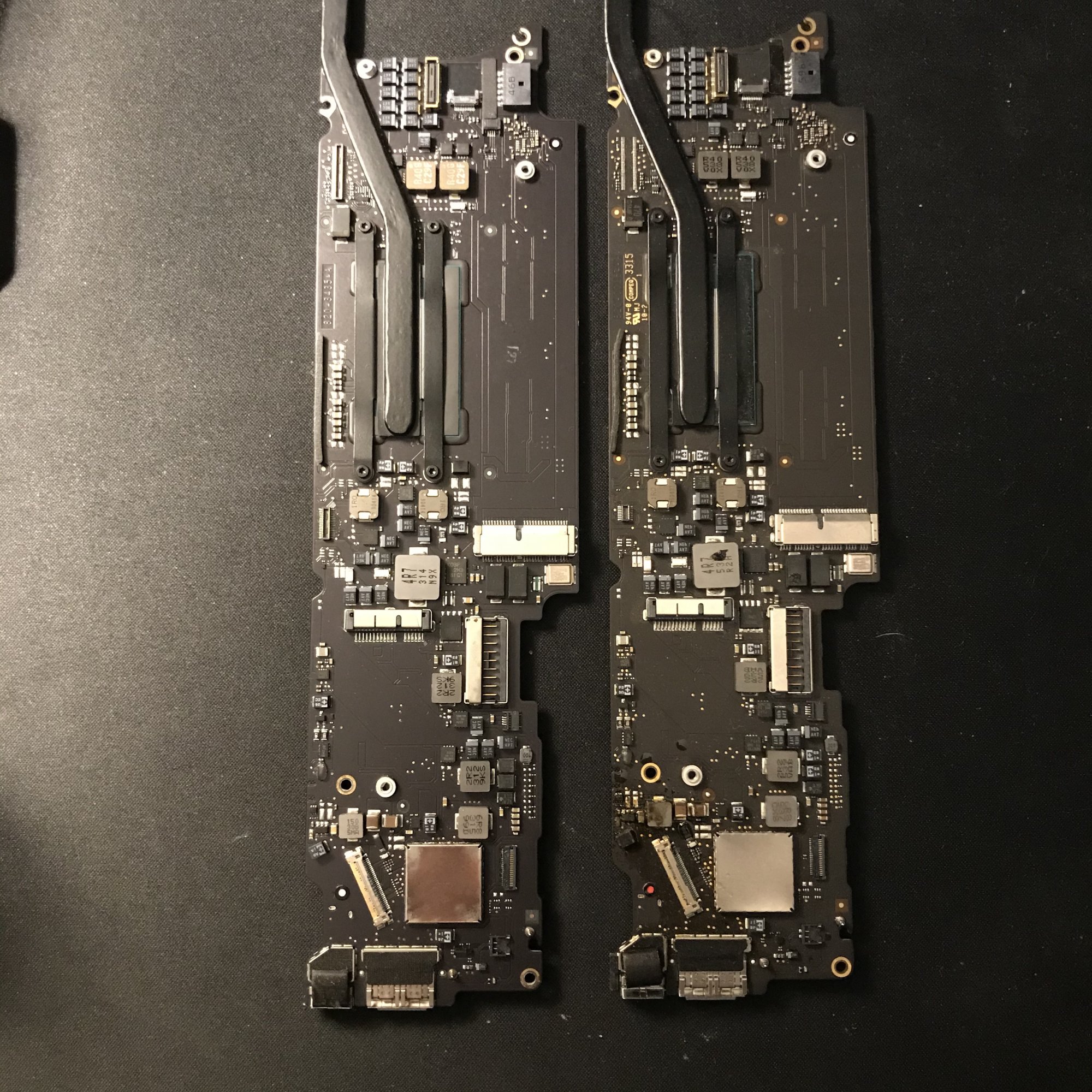

Logic board swap worked out well. 2013 board in a 2015 MBA with 2015 SSD. However, I shorted something on the board due to a bad display connection and I am back at square one. 2013 on the left and 2015 on the right. Direct fit. This means you could also upgrade a 2013 to 2015 specs.

For the mid-2013 to 2017 13" MBA, all components are completely interchangeable. Same for the mid-2013 to 2015 11" MBA.
I believe the short is in the LVDS cable which caused a permanent short on the 2013. If that is all that's wrong with both boards, they can be fixed by a competent repair shop that does board-level repairs. This will probably involve bypassing some of the video connections on the logic board connector by soldering fine copper wires between LVDS cable and a couple of alternate video connection points on the logic board. Replacing the LVDS cable would solve the problem but the probability of damaging the LCD during the cable replacement are very high.
