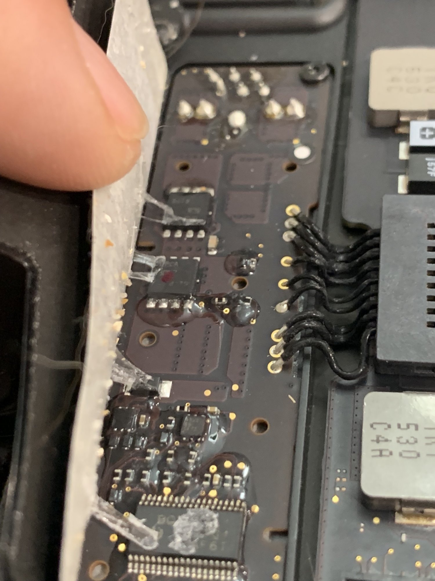

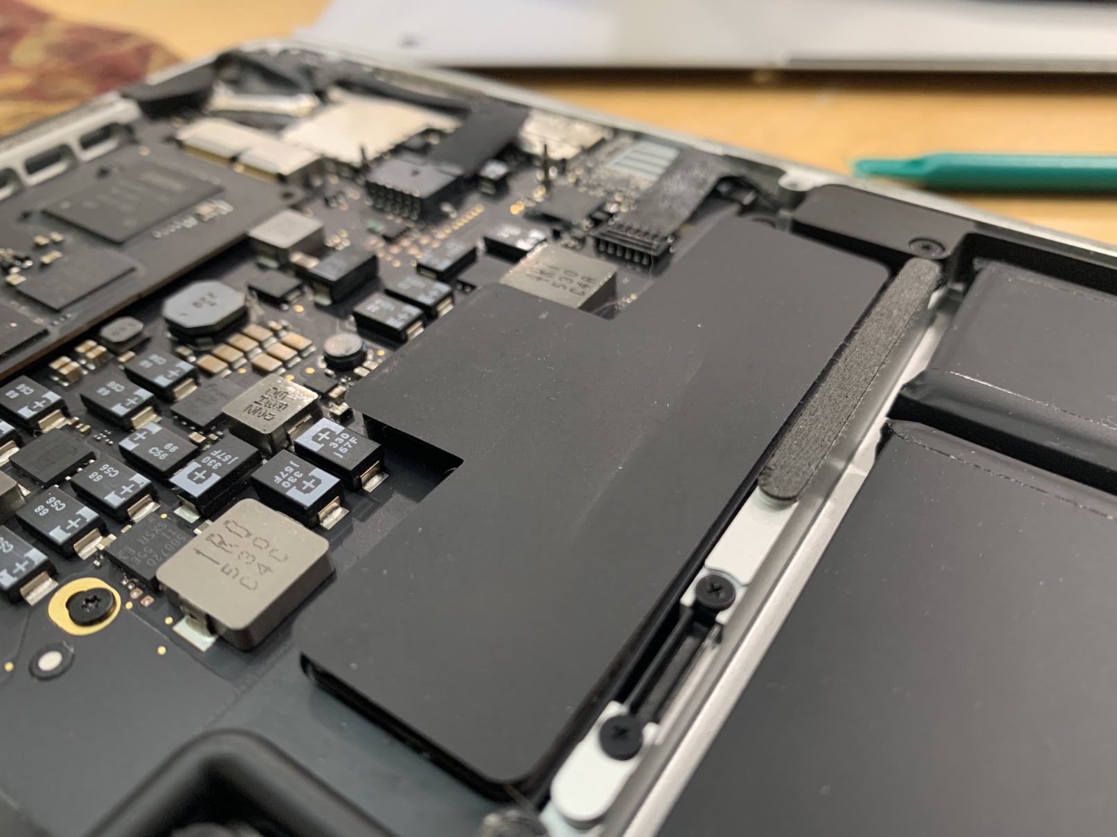

Opened up the MBP (the first time on this one for me) and initially saw an indentation on the plastic cover over the battery circuit board. I thought maybe one of the rubber nibs on the inside of the bottom case may have done that when dropping it as mentioned above, but the nib fits into a slot and doesn't come near that plastic cover. It was either there from manufacturing or done when the Apple Genius Bar replaced my battery. I see that one of the wires to the battery circuit board is bent out of the way a bit, probably also done by Genius Bar. That WAS 3 years ago, so I can't see those 2 things being an issue. I've attached 2 pics. I suppose the battery circuit board could be replaced as well. I'll at least order the MagSafe In Board. Not a lot of money. If anyone sees an issue in the pics, let me know.
