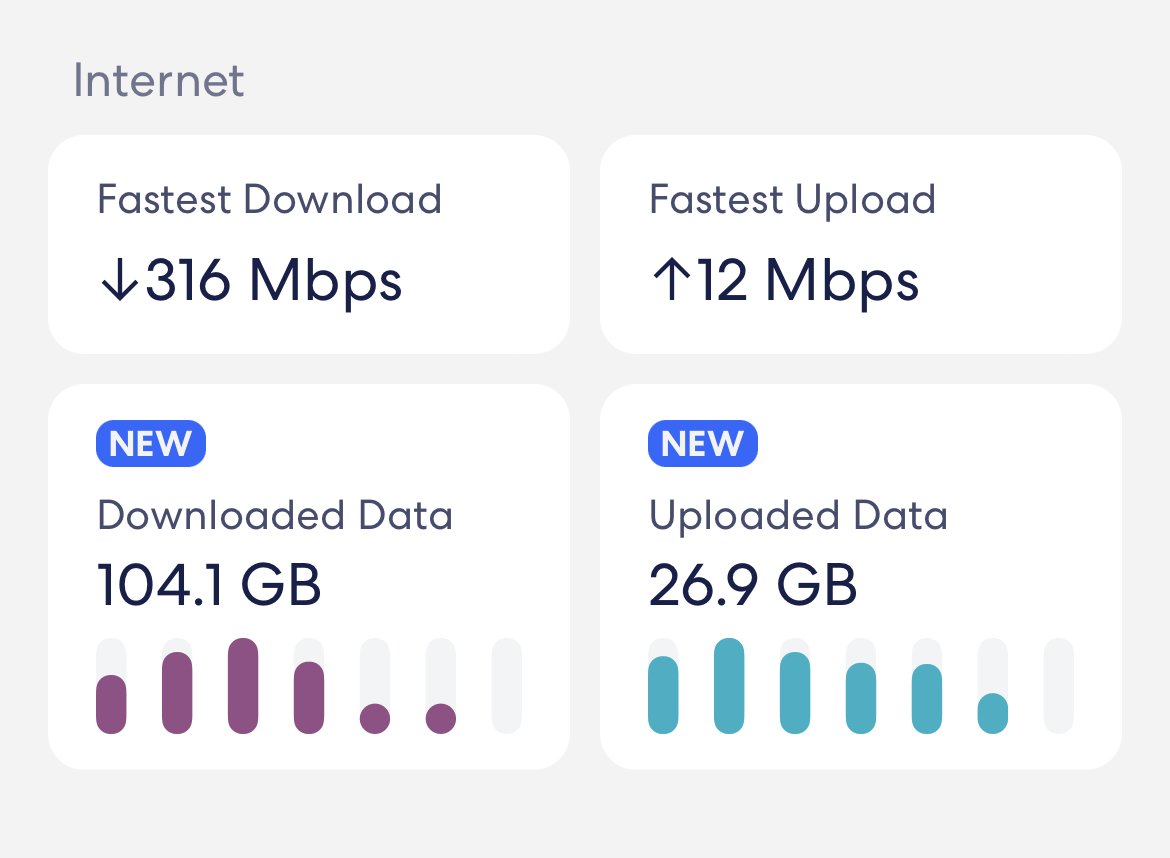

Here’s a screen shot of what I’m getting. I’ll enable that now. It says it will limit certain devices. That’s ok?

Here’s a screen shot of what I’m getting. I’ll enable that now. It says it will limit certain devices. That’s ok? View attachment 1995205
With only 12Mbps upload, it will almost surely bring an improvement. It trades about 10% of your throughput for guaranteed low latency. Good for making sure a FaceTime call isn’t knocked out by a console or computer downloading some big update. Or in your case, the cameras using up almost all your upstream bandwidth throughout the day.
Awesome. Thank you so much! I can’t believe nobody at Eero suggested that.
