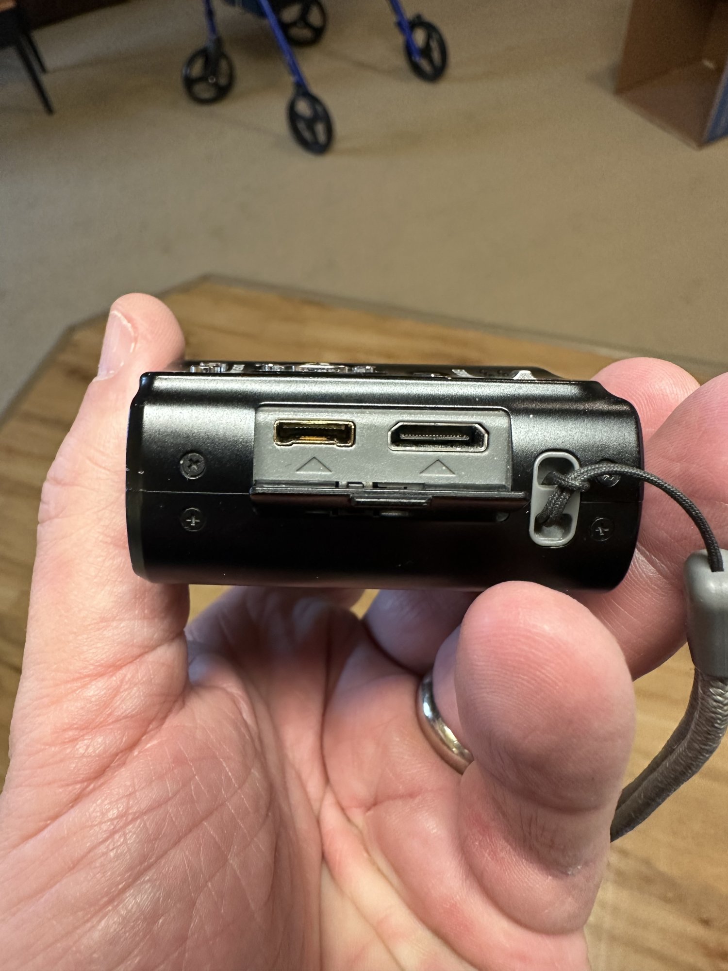

I'm not sure about the camera port. Would I need a micro-USB to USB 4? He can't find the old connector so I'd like to get him a replacement. Dude is 96-year-old so getting a new camera probably isn't the solution. He'd just like to get the existing photos off of this camera on to his brand new iMac.

^^ this.

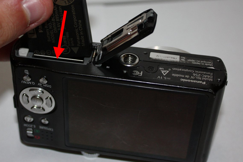

On the bottom, there is a latch to access the battery and SD card.
The two connectors you showed: First one is a Lumix custom connector and needs a special cable to connect to USB. Second is Mini-HDMI to connect an external display to directly play content from the camera on a big TV.
