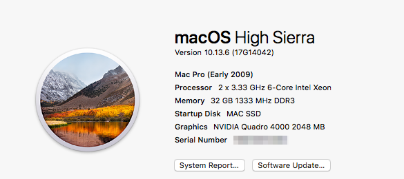

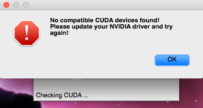

Hello everyone,,

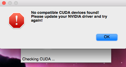

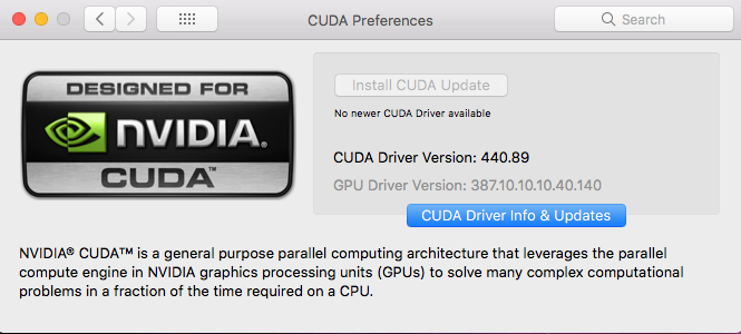

i have a mac pro (Early 2009) Upgraded from 4.1 to 5.1 with Nvidia Quadro 4000 (for mac) on high sierra, the problem is , i can't use CUDA no matter what i do, i installed the latest web drivers and updated the CUDA drivers, but Nothing seems to work , when i open Premiere Pro or DaVinci Resolve i get OpenCL only.
Sorry if this topic is already discussed, i searched everywhere and i didn't find any solution to this problem.

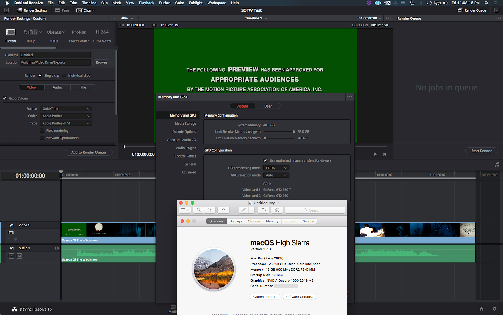

my mac specs is in the picture below.
Please Help , and thanks in advance.

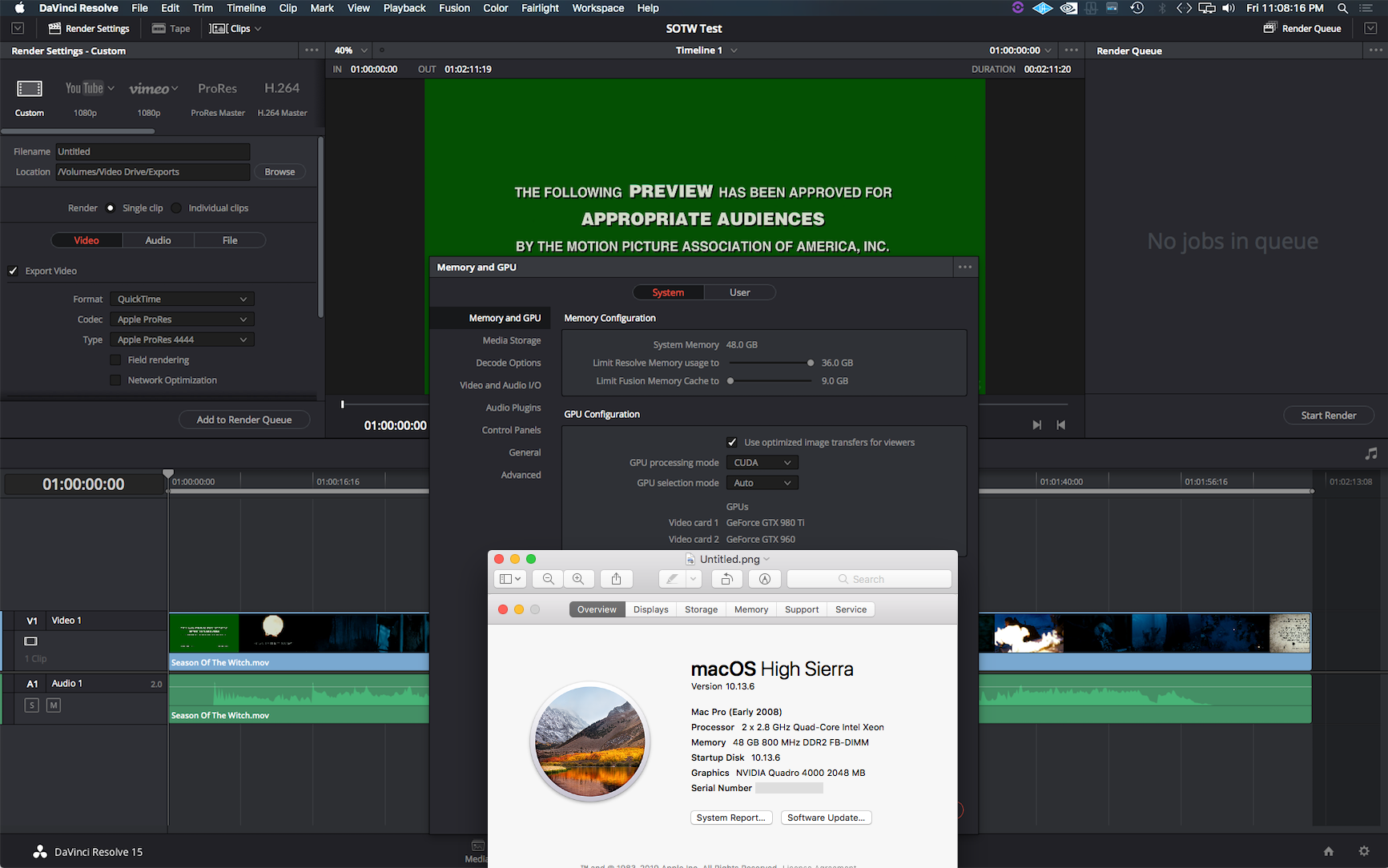

It's been awhile but if i remember correctly, the Nvidia card that uses CUDA must not be the one attached to the monitor.
The example below (DaVinci) the GTX 980ti and GTX 960 CUDA cores are being used
The Quadro 4000 is not on the list (like yours it's connected to the monitor(s)
Also, the Quadro 4000 has only 256 CUDA cores. With 32GB of RAM you are better off using the memory.
To test this theory, connect your monitor to another GPU (if you have one) and switch back and forth exporting files. They say CUDA is 30% faster than OpenCL. But 256 CUDA vs 32GB I see CUDA losing.
The down side is how and how much $ would it take to compare "real" CUDA numbers vs your 32GB of RAM?
The two cards shown in DaVinci have a combined total of 3840 CUDA cores. In today's CUDA world that is nothing! The RTX 4090 has 16384 CUDA cores!

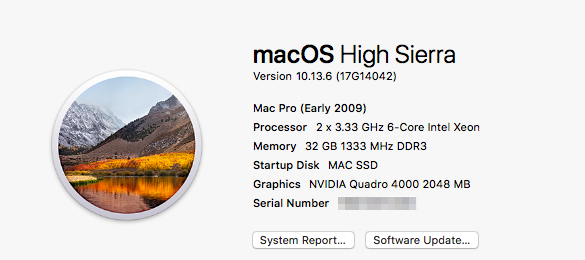

Hello everyone,,
