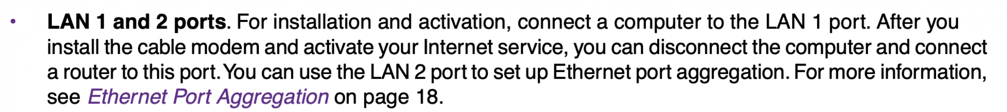

I believe the multiple ethernet ports are for the purposes of ethernet link aggregation (multiple physical connections, but a single logical connection) to a single router (that is compatible with link aggregation), not for the purposes of connecting multiple devices. Basically you get higher speed by having two parallel "pipes" connecting your modem to your router.
User's manual should be able to explain. Screen Shot 2021-09-10 at 3.43.47 PM.png
