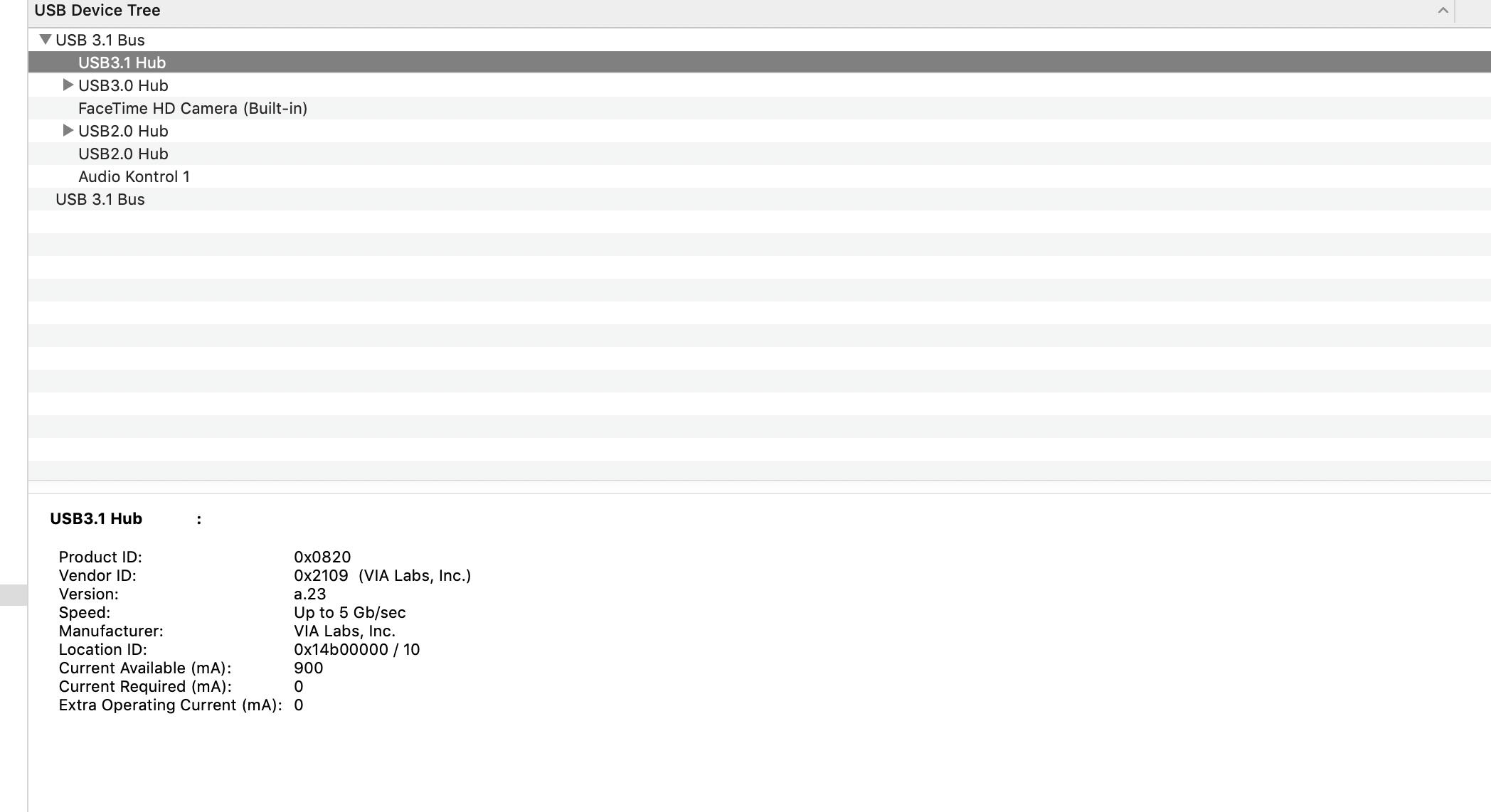

i've bought a usb 3.1 gen2 hub, but osx tells me its 3.1.gen1.
