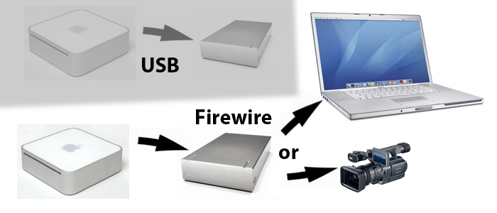

I don't know which Mac Mini you have, but FW might be an option, but FW400 has a maximum of 40MB/s and FW800 (on the 2009 Mac Minis) has a maximum of 65MB/s. S0 FW800 might be a good choice, if possible of course.
Also when using FW (400/800), you can daisy chain FW devices (up to 63), as most external HDDs with FW come with 2 ports of the same FW family.
So you can use the FW port of you Mac Mini to connect the external HDD to it, and then user the other free port on the external HDD for connecting it to your MacBook Pro via Target Disk Mode (or via a FW ethernet, like a LAN just with FW as cable and with FW speeds) or the video camera.

There are LaCie drives with FW, even the model I took for the "diagram" has FW.
