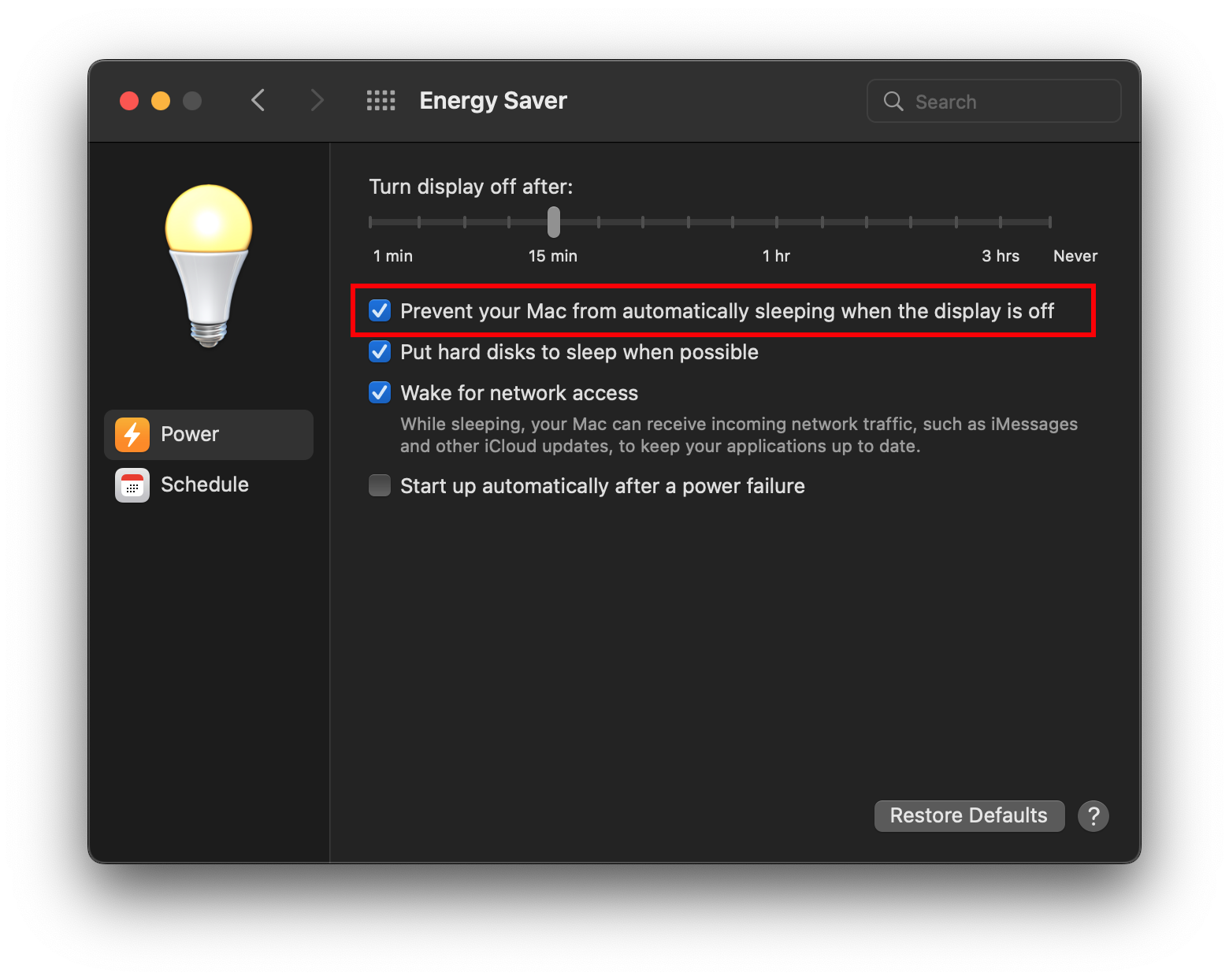

The only really solution to fix this is to disable the sleep mode of the Mac. The on/off problem will start, after an Apple Silicon Mac wake up from sleep.
Manually Sleep also bring back the on/off issue. So Shut down your Mac if you don't use it. Only solution is not use Mac sleep anymore.

Hello, I have Mac Studio M1 base model Sonoma 14.7 and LaCie D2 Pro 16TB external HDD connected directly to Mac Studio using the original LaCie USB-C cable. In MacOs disabled option to spin down HDD and also enabled option not to sleep when screen off. The external HDD is stubbornly spinning down right after its up then down. Makes it really difficult to edit video in FinalCut Pro or even watch video from file stored on the external HDD as it pauses again and again to wait for the HDD to spin up.

I've tried this, which should disable disk sleep altogether, but it did not help:
Bash:
sudo pmset -a disksleep 0
Disabling sleep all together however fixes the problem:
Bash:
sudo pmset -a sleep 0
The price I pay is lack of auto sleep. In my case it is acceptable. I am putting the system into sleep whenever I want it to and I only leave it running when I want it to run.
