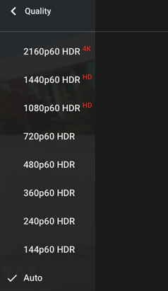

Ok, I can confirm that when I connect external display directly from HDMI port of MB Pro 14", HDR on YouTube in Safari works just fine.
Now I try to play Dolby Vision on Netflix, but I can't tell if its working or not.
