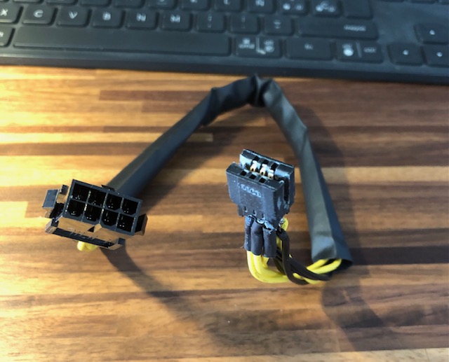

Yes, you can. But no output yet. But can use as compute.
You only need to attach a DIY power connector in the Botton. (I use a Razor core X)
+info: link
juantrix
macrumors newbie
Apr 28, 2021
5
1
I used a 8pin female (pcie) to a Side A/Side B connector to power de card. I tried a W5500x.

Yes it "worked". Inspired by @tsercitpo build a power connector for the MPX Module (instead of solder it), so installed it in a egpu case. Connected to thunderbolt to my Hack it was detected, funcional but not optimal (4x vs 16x) & no output. Only for compute purposes.
Finished return it.

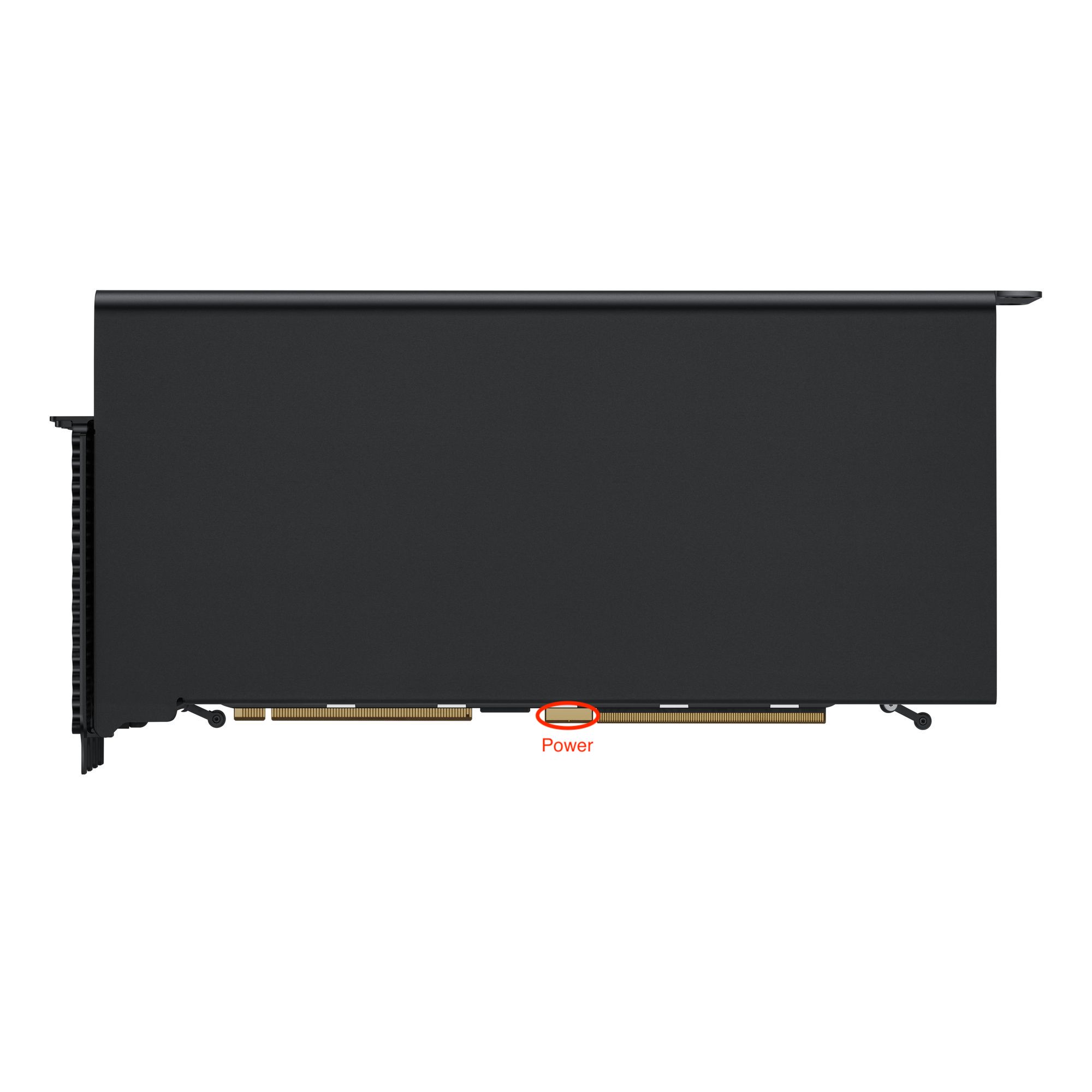

I think the MPX Part, add video connection (output) to thunderbolts port in MP2019. If the video card has TB3 output (include JHL7xxx) it need additional PCIe lanes too.
Pcie 16x is standart.... only need to add power.
Yes, the MPX part can have up to four 4-lane DisplayPort 1.4 connections and two PCIe 3.0 x4 connections.
Each Thunderbolt port (up to four) also requires a USB 2.0 connection (need to verify that by connecting a USB 2.0 device and checking what controller it is connected to).

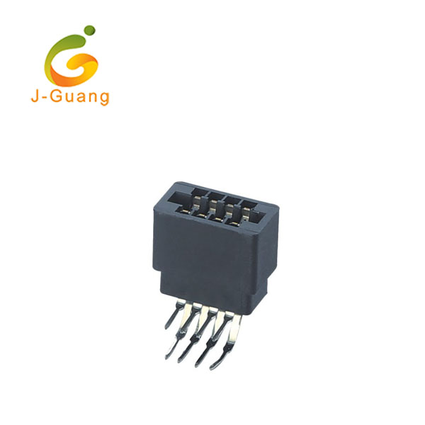

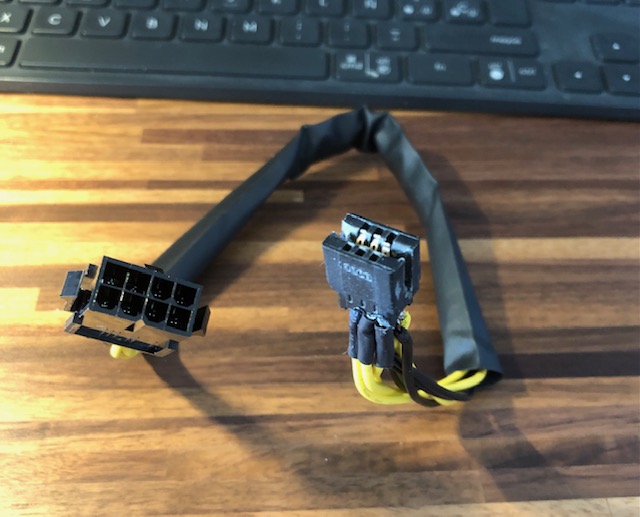

I used a edge card connector (6pin in my case) extracted from a MAC G5 Board (AGP GPU Power). Cutted the sides to insert the card. You can find this or better edge card connector from diferente sides.
My Razer eGPU uses a 8pin to power the GPU, so I buyed and modified an extensor. All 12v fires to one side and Ground to the other.
And the extensor for the PCIe 16x.
At the moment, you can use/buy a better/more power card from PC with video output & unnecessary mod.
