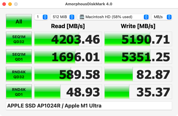

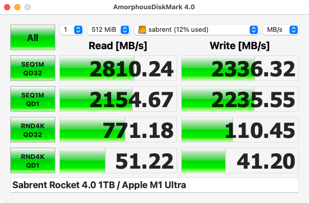

Internal VS External storage:
Although the Mac Studio's internal SSD has higher top end speeds, that's where the difference ends as an external Sabrent Rocket on Thunderbolt outperform the Studio's internal SSD with smaller files. While booting from thunderbolt in an option, the boot process takes a bit longer. Personally I agree - buy as much storage as you can afford.
