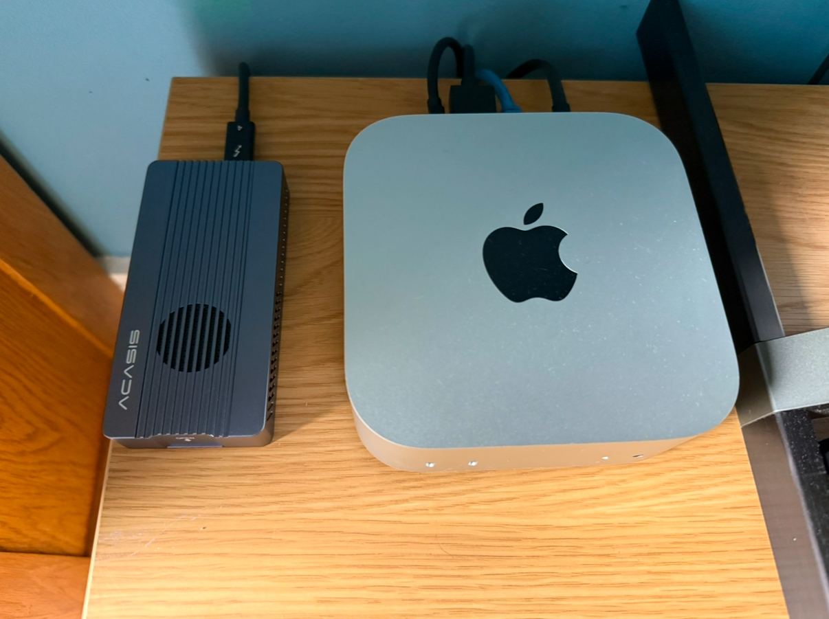

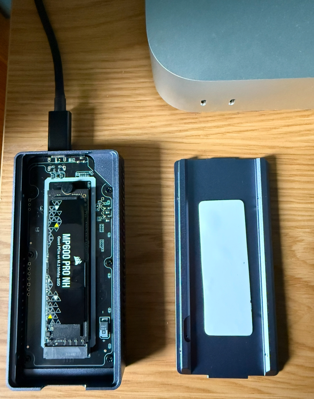

Finally I bit the bullet and bought the Acasis enclosure with the built in fan. I didn’t want to spend £105, but given my experience with the smaller fan enclosures I thought it’s worth a shot. LED is perfectly balanced, noticeable when looking for it but not overly bright. Fan is larger and quieter, I mean whisper quiet in comparison. It’s barely audible until you place your ear to the enclosure, and it shifts a fair amount of air too.
Read/write are up in the 2700Mbps range which is a perfectly acceptable tiny drop for me. The fan is switchable too. Even with the fan off I’m seeing temperatures in the 40c range with hours of use. I wish I had spent the extra to begin with.
My recommendation is the Acasis, however, if you can get away with a fanless unit and want to spend less I suspect many of the large/full lid fanless style units would perform equally well. I’m happy with this as a solution as I trust the temperature range with my 8TB disk for for always on usage.

I just got the Acasis with the fan as well. Using it with a Samsung 990 Evo Plus and I agree that it's great. Very quiet and cool.

I’m really impressed with how effective the Acasis is. My setup is used as a media server too and is in the living area so the last thing we want is a bright LED and loud fan. It’s silent from anything more than 10cm away, not that it needs the fan running 24/7 anyway as the enclosure does an amazing job at radiating the heat passively.
Size next to M4 Mini if anyone is wondering:
