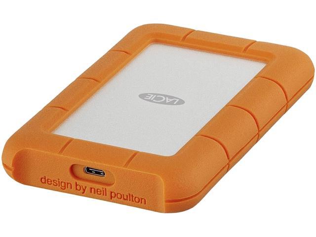

So true, the search is on, and I am searching for used equipment to augment the cost. I just found this video now.
Hello I’m interested with that solution do you know if that rugged version (stfr2000800) would function?
thank you
thank you
Yes, it would function if you plug it to the USB-A port (using USB_to USB_A) adapter.
No, it would not function if you plug it to the Thunderbolt port.
