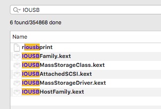

I did a search on my 2018 Mini (running Mojave) using "EasyFind" (using IOUSB as the search string) and came up with these hits:

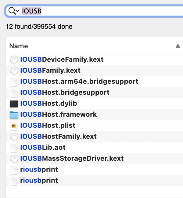

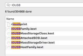

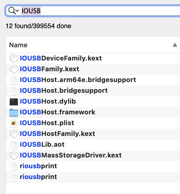

I did a similar search on my 2021 MacBook Pro 14, and got this:
So... yes... it seems the kext (from Mojave) named
IOUSBAttached.SCSI.kext
...is missing from Monterey.
