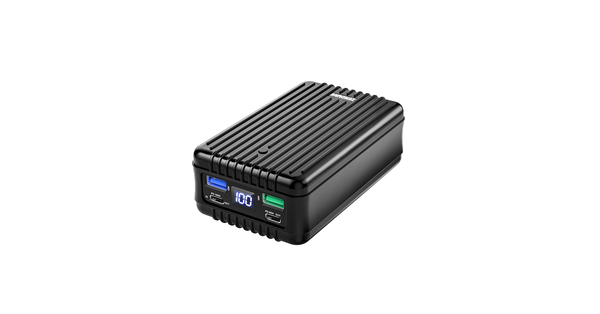

I just received the Zendure Supertank Pro, and started trying it out with the MBP 16".
Yes it can charge the MBP 16" at 100W!
A great feature is that you can see the power output being delivered on the display.
What would be even better is if there was pass through charging with the MBP, though that may not be technically possible. (It will pass through charge e.g. an iPad Pro).
