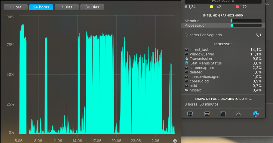

I have exactly the same situation on my MacBook Pro, already investigated it for some days, did a fresh install, but then I did a migration of my time machine backed up USER to the new installation (just the user stuff, not the system stuffs) and I have the problem again.
I already know that if I install Caffeine or Amphetamine (both apps to keep the system awake) the problem does not occur.
I can disable option to computer sleep and disable scrrensaver and disable turn-off (dark) the screen , the problem happens, so I can let Activity Monitor opened on the screen, wait for some idle minutes (about 6 minutes) and I can see GPU going extreme on Windowserver process.
This is screen capture of the last 24hr about the GPU activity [all high usage below is during IDLE times, and then this happens)

There is no need to have any app running, this is caused by the MacOS itself. (strange)
Also there is no need to the scree to go dark. I just have to let the system idle for some minutes.
How did I notice it?
I just noticed this strange thing because during IDLE periods of time, my macbook chassis was hotter [than when I left it alone], so I suspected something was being processed every time I was lefting my Macbook "alone" and idle.
As soon as I move the mouse pointer, the "thing" disappears and there is no more strange activity on GPU.
Yeah, seems like the exact same problem that I am experiencing. Unfortunately I still can't figure out what causes it, but it seems like a rare bug since you are the first one confirming the issue is not just on my laptop. The 6 minute window you give seems pretty consistent with what I have been experiencing, and as you say as soon as the cursor is moved the problem disappears and the GPU is back to normal.
