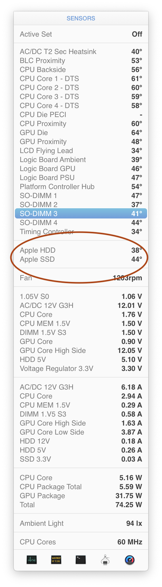

I don't have the same imac as you do, but on my machine, iStat Menus breaks down the various temperature sensors like so:
note the HD and SSD readings. I'm thinking that your imac reads an anomalously high temperature from your now missing HDD
