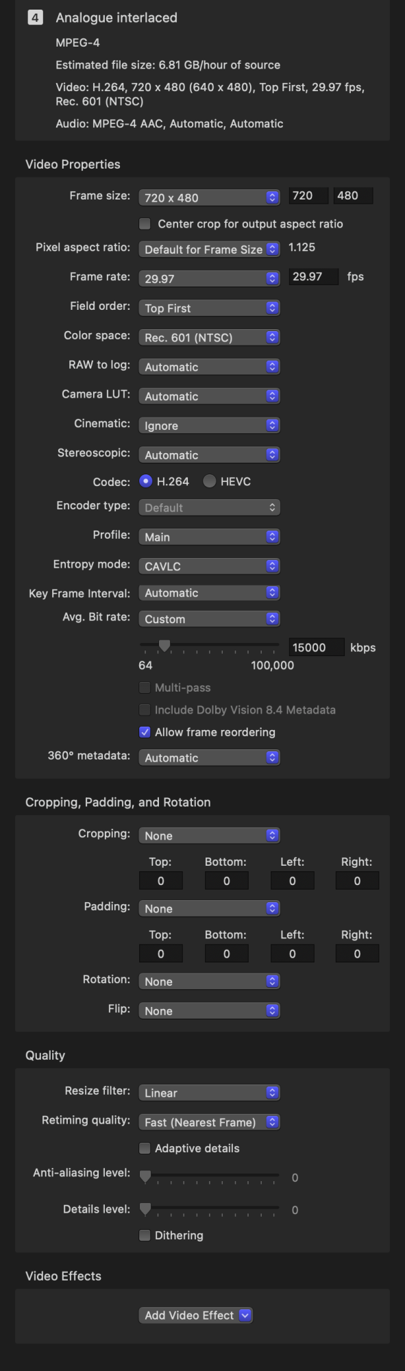

I have been testing FCP and Premiere on my new M4 Mac Mini.
I have transferred a Hi8 analogue tape that only has a mono channel of audio but premiere sees it as stereo so I switched it to dual mono and ran the audio enhancement wand. Also cropped the video.
2 hour video at a 12-15 MBps export
480i from ProRes 422 LT to H264 interlaced
Took 15 minutes on compressor and 11 minutes in Adobe Media Encoder. In Premiere I did a denoise as well as fill right channel with left. Yet Compressor was significantly slower at export. Why was that?
Is it possible that Adobe Premiere Pro is more optimized over FCP on the M4 Mini?

H.264/265 has SO many endless settings and variables, and any number of encoding engines can be used. So there is no comparing the two 1:1 without knowing ALL the details. Entropy mode, data rate, CBR, or VBR, single or multi-pass? Which encoder, how much RAM you have, etc., etc. Or if the final result is even comparable. Because I can transcode something for you in seconds, it'll just look crap.

Like my post says M4 mini base so 16 gigabytes of ram…
Secondly my post also shows my settings that I am using including g nitrate in compressor.

In Adobe encoder I was using g the same resolution, 1 pass VBR 15000 kbps.
I have no idea what that means nor do I see "g nitrate" anywhere in your settings, so I have no clue what you mean. But if that's some non-standard something, then that's probably your answer as to why it's slow.
Again… no clue.

Then clearly the "g nitrate" thing, whatever it is, is garbage. Any Apple Silicon Mac should hardly even notice a super-basic transcode such as that, which, when not futzing with some random other codecs or utilities, is all done on the Media Engines and therfore has exactly zero relevance in terms of CPU/GPU and certainly doesn't go to 100+°.
So the Mini is obviously not the issue or culprit here.

Again… no clue.

You are probably comparing Apples & Oranges. One is using a software encoder, the other one a complete different software encoder.
I don't think the hardware encoder can handle interlaced video, that's something every codec developers hate and avoid if they can.
Pobably Premiere H.264 encoder is a bit more optimized, Apple's software encoders were never fast.
