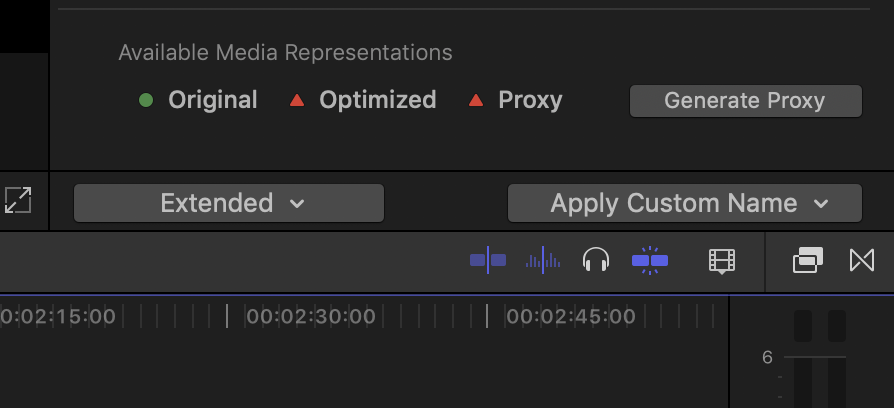

I believe there is an option in 3.4 at the clip info page called "Log Processing" (you have to search though the different options but it is usually found in the extended tab)
It has LUTs for many different cameras including Sonys. It doesn't have the L709A you were given, but it definitely select an Slog2 Lut which is almost the same. (L709 is based on the rec709 lut but tweaked a bit by Art Adams to much the footage by the Arri Alexa camera. Hence the A in the name)
I don't remember if there is an option to search the finder for a lut. If there is just pinpoint the correct folder and you will be able to load it.
