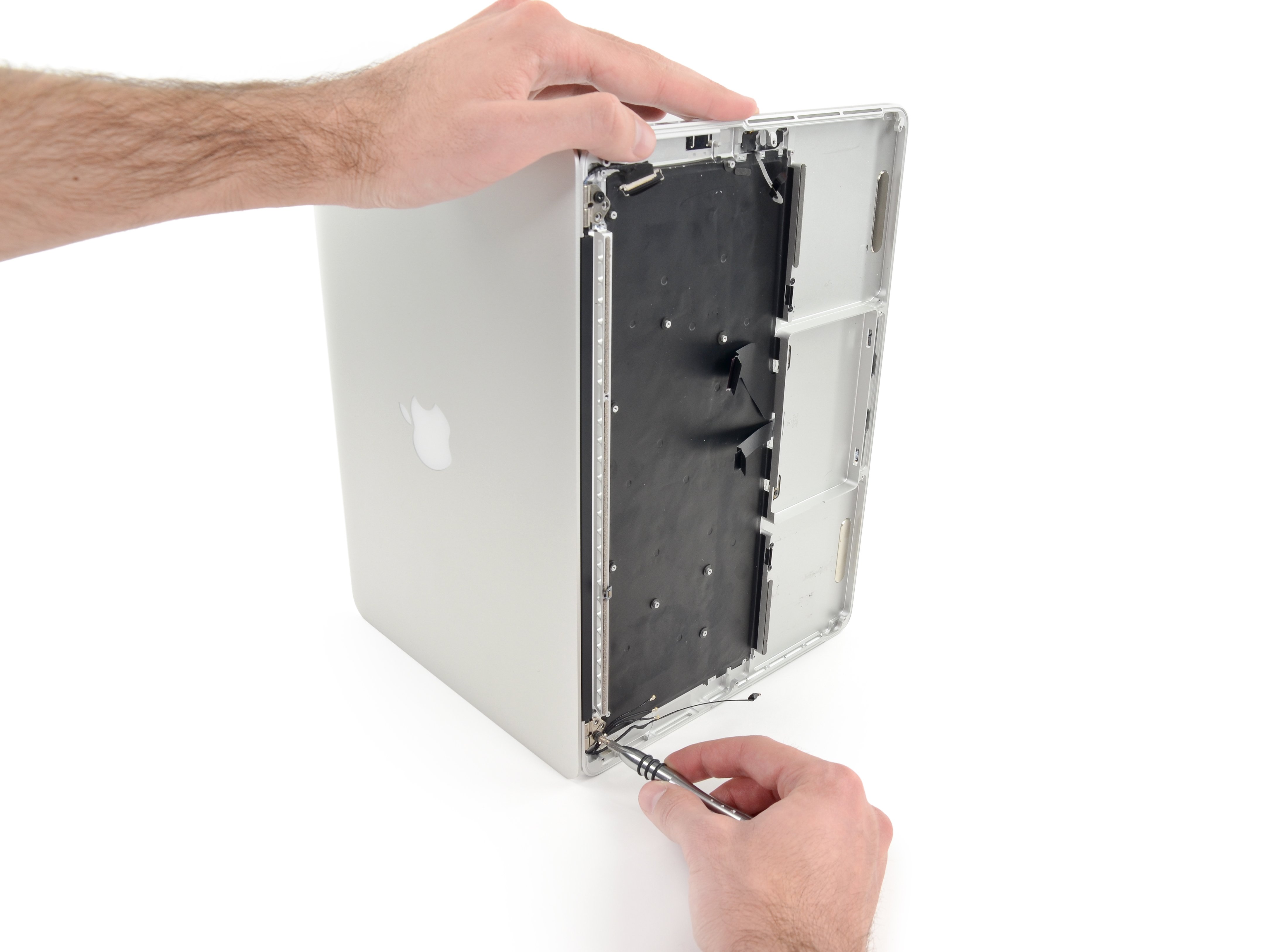

This is what it takes to replace the keyboard (which is part of the upper case). 80 steps! And that assumes the keyboard is the only problem.
