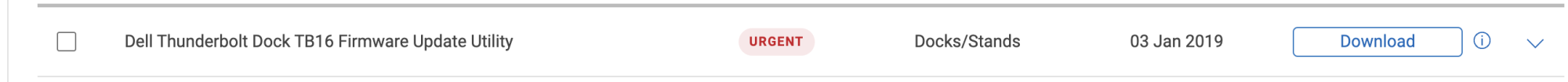

did you need to update the TB16 firmware?
I think mine has this update applied. I haven't updated it recently as I don't have a Dell laptop anymore.
But I can tell you that with this same version, it didn't work with my old mbp.

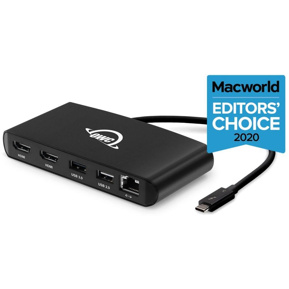

This guy (currently on sale) + spare MBP USB-C charger is Plan B. I don’t need the spare HDMI, and I wanted at least pass through charging (for a true one-cable-does-it-all solution, what TB should be), but oh well. You just can’t have it all buying a dock or hub.
https://eshop.macsales.com/item/OWC/TB3MDK5PO/

UPDATE 2 Received the OWC hub and it's working properly.
