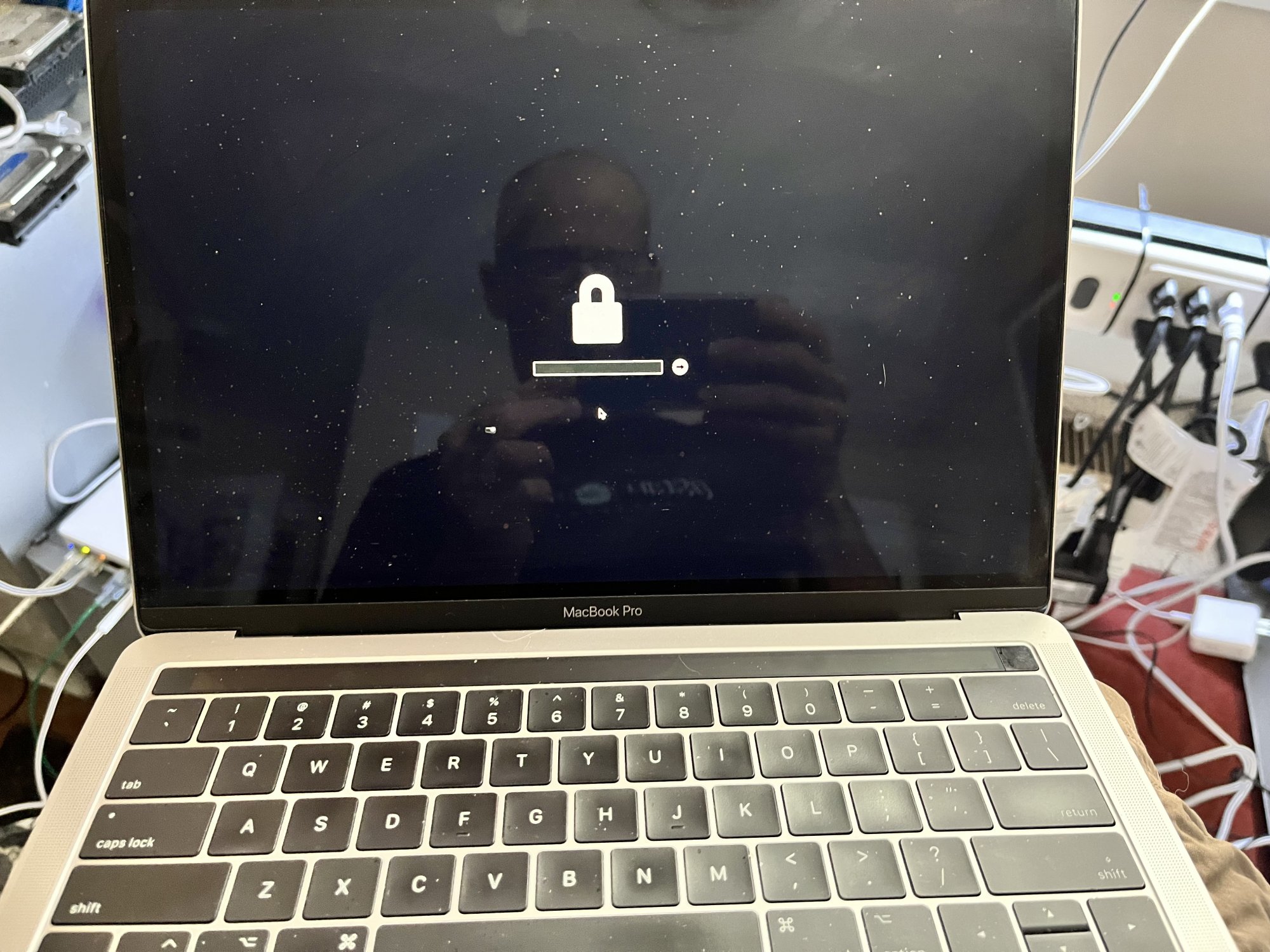

I have 2017 MacBook Pro running Monterey. Upon startup the firmware password screen appears. I currently don't have the firmware password but I do have the password for my user account. How can I make the laptop boot normally to my user account login screen?

When the computer turns on it is requesting a firmware password. This week at some point it booted normally to the login screen. Now it does not.
Any suggestions on how to get it to boot to the normal login screen is appreciated.

@brainwave89 - the firmware password will have a padlock next to a password box, and does not show a username, just a blank box for the password (with a padlock).
Are you sure that is what you see?

Thanks for your reply. If that is my fate I have no problem going to an Apple store. I find it puzzling why upon startup its asking for the firmware password when it should go to a normal login screen.
Can you post a picture of that firmware password screen? (just curious!)
Just making sure that you don't have a drive unlock screen (for Filevault encrypted drive), but that's certainly a firmware password. Thanks
