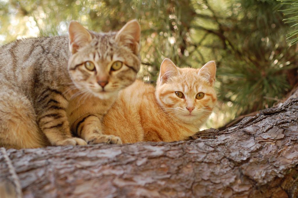

For the first time yesterday, I used the Nikkor 50mm prime f/1.8, which doesn`t autofocus on my D40. There are a lot of stray cats in my area and I stumbled on a couple of them chilling out in a pine tree that afternoon.
Here are a couple sample photos with a few questions.
1/200sec, f/1.8
The face of the cat on the left is is seems pretty sharp, but the one on the right isn`t. It was probably four inches further away from the camera. Is the depth of field that shallow on f/1.8? Or did I just accidentally leave a few inches of air in front on the cats in focus too?

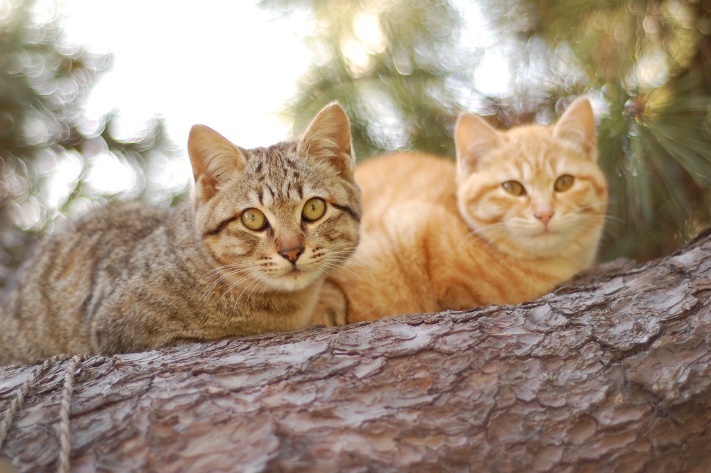

1/80sec, f/3.5
Here, I`ve gotten things the other way round: it`s now the cat on the left that`s out of focus (after it decided to stick its head forward an extra two or three inches). But the aperture is now down to f/3.5. Presumably that means a much bigger depth of field, which means I`d left a fair bit of empty space behind the cats in focus, right?
Generally speaking, is there a guide about how great a depth of field I`ll have with each f-stop? Is there a table that says how many centimeters/meters you`ll have in focus on each f-stop? How much does this vary between lenses?
Does anyone have any tips, beyond just practicing a lot, for learning to get sharp manual focus? I`m not sure what this could be, but maybe someone can recommend some useful exercises.
Oh, and I also took some photos that are just slightly fuzzy round the edges and I think it creates a dreamlike quality. If you want an out-of-focus photo like this, does it make a difference whether you do it in camera or on the computer later?

You would see exactly the same problems with autofocus if you focused on either cat.
Just to check, do you know that the focus indicator in the viewfinder still works when you manual focus? You should be able to point at a cat and wiggle the focus until the green light on the bottom left comes on.
You must have been fairly close to those cats. I would have thought that f/4 plus maybe a step to the right would have gotten both of them into focus.
Agreed. f1.8 is too shallow for that, estimating that you were about 6ft away. f4 would have done the trick, possibly even f2.8

Also, you can take decent shots with the 50mm f/1.8D right down to 1/15s but only if you take lots of shots. Half of them will come out shaky but you will get one or two sharp ones. You could have walked up to those cats at f/5.6, firing away and adjusting focus and probably never have to worry about depth of field.

If I`d shot these in raw, would I have been able to prevent the background from being quite so blown out?
It seems like the cats are in shade, or at least they are considerably darker than the adjacent sky. You need to reduce the contrast between the cats and the sky, either by framing the photo differently or by using flash to provide fill light.

Cliff3, yeah, the cats were in the shade of the tree. It was a sunny day and there was a large gap in the foliage behind them. I could step to the left a little and remove the bright sky from the frame, but at the expense of having the cats facing away from me. I considered using fill flash but thought they`d run away (this is the first time in six months they haven`t run away from me).
Maybe I could have asked someone push a couple tree branches across to block the light.

The composition is better, but it looks like you missed focus by just a little bit:
If you look, the eyes and most of the face are in focus, but the chin is not. This leads me to think the actual focus point was a few inches in front of the cat.
