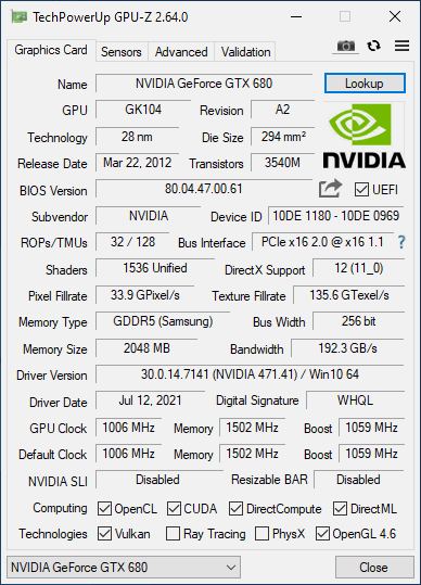

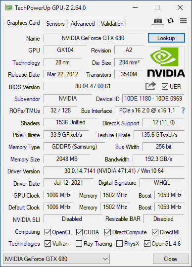

The nvflash for Windows runs perfectly with Windows 10/11 on my MacPro5,1.

Probably been almost a decade that I last flashed a 8800GT, maybe you need an even older version of nvflash.
For Kepler GPUs 5.134 works perfectly, did several reversion to PC firmware + 0x10038 UEFI GOP module in the last few days to avoid issues of the macEdition with the DP port.
