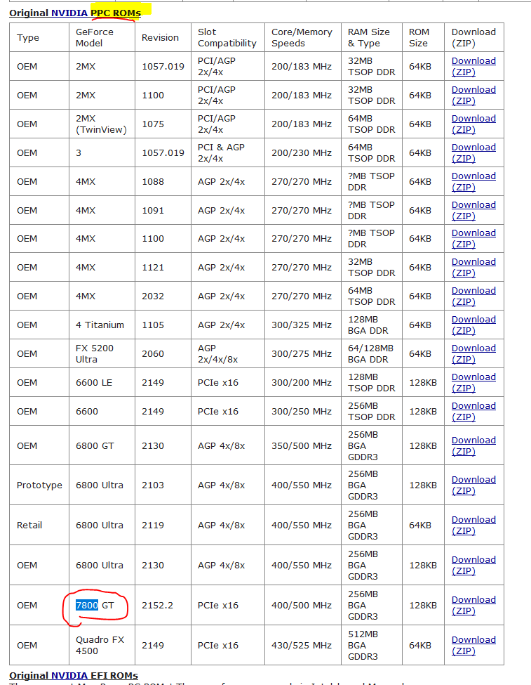

This is an obscure card for the Power Mac G5, but I have heard of it being done and I know someone here did it by replacing the ROM, but I think I have heard of doing it without having to do that.
I bought an unused 7800 GT with 256MB of video RAM.
Ignoring I have no experience whatsoever with flashing video cards before, I could probably figure out that and I know I can replace the ROM chip with the other if need be, but my problem is finding compatible Apple Firmware.
I ask that if any has an Apple branded card or what if they can give a copy of their firmware, if that is safe to do. Or a compatible firmware in general. Like is the Apple 7800 GTX firmware compatible?
[doublepost=1544912596][/doublepost]LoL, I found it: http://themacelite.wikidot.com/wikidownloads2
This is specifically the download link: http://campahunta.free.fr/Downloads/ROMs/nv_oem_7800gt_2152_2_pcie_full.rom.zip

Sadly you will likely not have successful flashing without replacing the EEPROM chip.
As you can so on the themacelite webpage, the size of the Mac ROM is 128kb. The size of the EEPROM chip on PC Cards is only 64kb. You won't be able to successfully flash the Mac ROM to this chip. Won't fit. That was the reason for replacing it in my thread. After replacement, one still has to flash the card as if it were an unmodified PC Card.
That said, replacement isn't that hard if you are handy with a soldering iron. I might be able to find the spare chips that I could send for the cost of postage if you are interested in going that route.

Or you could edit the 7800GS rom to work with the GT.
Is this something that anyone has done? I guess the cards must be similar enough, but I certainly lack the expertise to modify the ROM and I think most people who do have moved on to modern cards.
It's documented on themacelite wiki how to edit the roms. It's not really very hard, in this case, just need to change the device ID, copy over the soft straps, and edit the other tables. Mostly just copy and paste from the PC VBios to the Mac FCode ROM.
http://themacelite.wikidot.com/nv-rom
I made the 7800GS rom, so I assume I know what I'm doing. Really all the work done on the Geforce cards from the GF5xxx was based on my hacks.
The wiki does not say where the firmware checksums are and how to calculate them. It is not difficult, but they did not write it there.
Yes, of course, the EEPROM chip needs to be replaced. I recommend using a hot air soldering station and a programmer. If not, then a soldering iron and a PC motherboard with two or more PCI-E slots for flashing will be enough.

Hey I ended up purchasing this exact same card, what was your fix to get it working in an MDD?
To add some more details I found details showing P.492n30
It works fine in FreeDOS on P4-PC motherboard. When I load the G4 notemp ROM off wikidownloads2 I get major artifacting when loading OSX apple. I assumed softstraps and timing were the cause. But the timing tables from Stock to Notemp ROMs are vastly different so I am holding off making the changes. Looking for someone who can help guide me a little further than generic NV ROM page has.
At first I've tried the procedure described in the MacElite wiki articles, dumping the 7800GS Lindbergh firmware and then proceeding to edit/cut/paste dozen of hex strings. The resulting ROM, once flashed back to the card, never worked as expected: while in OS9 the picture was clean, in OSX I had every kind of artifact, the desktop was there but ruined by vertical garbage. I've tried a second time from scratch but with the same results, in the end I gave up and purchased a BFG card (copper heatsink) where the MacElite "official" reduced ROMs worked perfectly.
After a while I decided to go back, once for all, to the FireGL X3-256 because its better support in OSX and a partial support in OS9: if you apply the "Radeon 9200 Hotfix" to the OS9 install the FireGL it will be able to detect (and select) the monitor supported resolutions, otherwise it will be sticky with the one from the latest OSX boot. No acceleration, of course, but at least when a OS9 boot is needed the use is a bit more comfortable.

Sadly no, I haven't no more the ROM I edited at the time but in my experience not all the Lindbergh 7800GS are the same. For example with the reference design (with silver heatsink) the reduced MacElite ROM didn't work but with another kind of board (with squared orange heatsink) it did.
I tried my best in accurately following the steps on the MacElite guide but I believe some extra undocumented customizations were done, some touches here and there made possible only by experience and knowledge.
I have also tried to reduce the X850XT Apple ROM following the other guide but it did not work also. I have wasted so much time in this kind of hex editing (without reliable results) that I really prefer go for the verified working hardware where the available modified ROMs works at first try.
