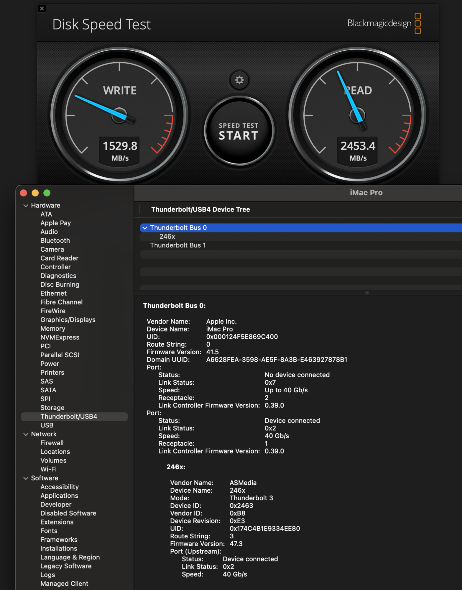

I just tested my Quiizlab USB4 enclosure on my iMac Pro, and everything shows up as it should, although the TB3 Write performance is only at the level of PCIe 3x2 channels...
Good enough. 😀
