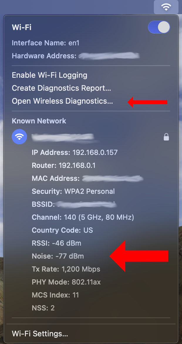

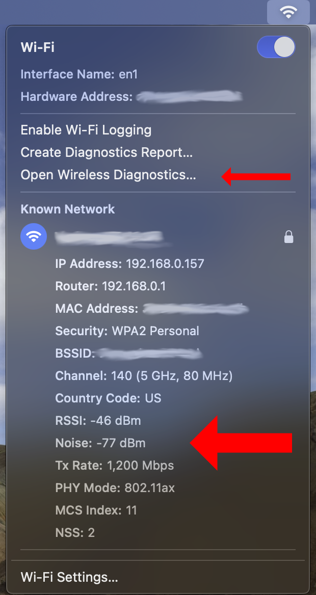

If you hold down the Option key and click the Wi-Fi icon in the menu bar, it will give you details about the network, and a place to create a diagnostics report. As you can see below, this provides you with details about your router and the network you’re using.
One of the first options is the automated wireless diagnostics tool:
Some of the relevant performance values you can read up about:
