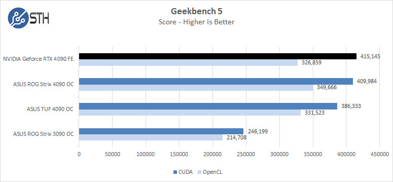

I don’t disagree that Cuda would give better results, and personally I always want to see the best possible results for a device, so I would welcome it.
Given Geekbench 5 included Cuda scores, I was a little surprised when it was removed at the start of Geekbench 6. John Poole was asked about this and I think it reveals how he sees Geekbench’s target audience and purpose. Essentially he sees it as a measure for consumer software and device performance. With that in mind his tweet about Cuda is revealing:
I was surprised to hear that Cuda usage was so low in Geekbench 5. I am a little less surprised to hear it’s usage is lower in consumer software given their tendency to want to use as few variations as possible.
All that being said, I’m not convinced the difference is as massive as you say, although I am open to evidence to the contrary. I found this Geekbench 5 comparison between the 4090 in terms of OpenCL results vs Cuda. The biggest difference was 27%.
I don’t know how OpenCL compares in terms of optimisation to DirectML. I had heard OpenCL was not great on Nvidia cards.
OpenCL and CUDA for classic shader code won't be a big difference, but for ML workload will be as you can't use Tensor Cores (OpenCL vs CoreML would be the same you can't use NPU from OpenCL so you can't utilize "accelerators", so you'll have scores that are most likely 10-15x lower if you do the same stuff on M4 iPad or iPhones as you'll be limited by GPU)
ML benchmark is totally meaningless if you don't utilize accelerators provided by system in one system but use it in other, in pure OpenCL limit for our AI workload would be around 50/60 Teraflops (around 70-80% max classic shader performance using CUDA cores) but in CUDA it'll be 330 Teraflops for FP32 <tensor cores> + 86 Teraflops of CUDA cores.
Not even saying anything about peak of 2600 Teraops for int4. And ofc. DirectML isn't accessing any of that "accelerators" at least not in this version, it just call DX12 shaders that only use ~x% (most times it is <50% and it is slower than just using PyTorch which itself is also pretty slow without compiling) of potential CUDA cores (so <50% of this 86 Teraflops).
Ofc we are still saying theoretical limit most models are limited by memory speed not compute especially if you have as much horsepower as newer GPU's and NPU's so neither ANE nor RTX 4090 will be able to use all of the Teraops/Teraflops in 99% of cases.
