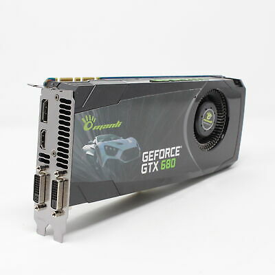

A Nvidia 680. If I bought it and flashed it with the Mac Edition 680 FirmWare, would it work with full graphics acceleration and EFI boot screen?

Plus concidering, that I want the original Mac boot screen and I have the resources to do it, It's easier and cleaner to do it as I wrote earlier. Just flash the card with a Mac Edition FirmWare, which is currently free to download.

There are several offers on eBay of flashed GTX680. Be bold and go for it.
I just buy a old PC GTX 680 2GB and flash it.

my plan is to buy a PC 680 and flash it for Mac boot screen support.
And I think, that all 680s have a double 6-pin connector. And my Mac has also double 6-pin plug.
So powering the card shouldn’t be a problem. 👍
Really? Mine needs 6-pin+8-pin combo.
If you already have the cable, that would be good.
Other wise, you will need to buy one or two cables.
It's called mini 6-pin to 8-pin PCIE power cable. Check well with the seller before ordering.
