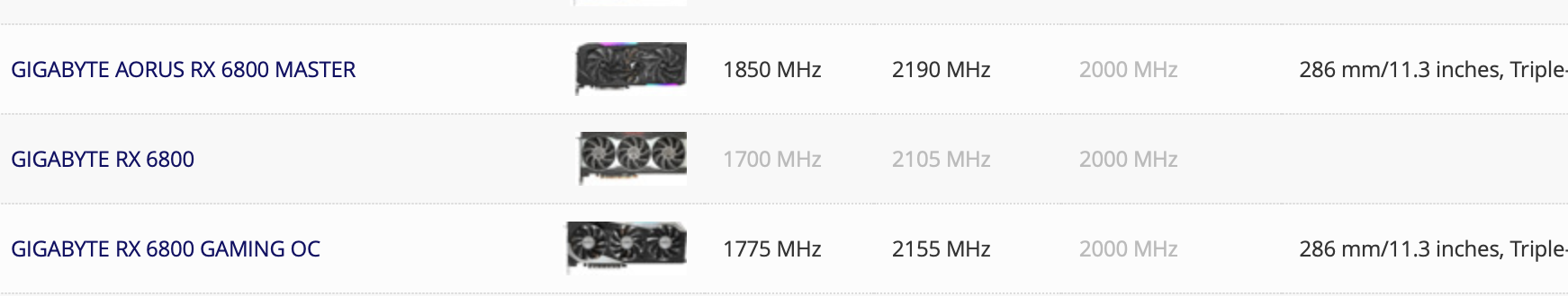

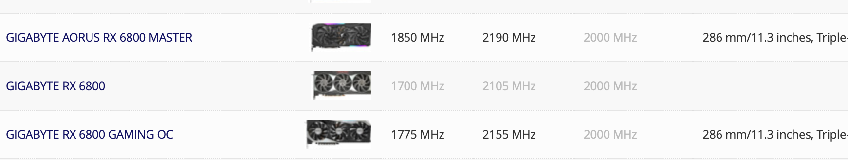

I do not know you budget. But if you are not going for a MPX card from Apple.
You can check the card lengths here RX 6800
These two cards should fit nicely, shorter that 300mm
From what I gather, it looks like these models are all 305 or under:
  • Most 6600XT Models
  • Stock 6800/XT cards
  • ASRock RX 6800 Challenger Pro OC
  • ASRock RX 6800 Phantom Gaming D OC
  • GIGABYTE AORUS RX 6800 MASTER
  • GIGABYTE RX 6800 GAMING OC
  • KUROUTOSHIKOU Fighter RX 6800
  • ASUS ROG STRIX LC RX 6800 XT GAMING OC
  • GIGABYTE RX 6800 XT GAMING OC
  • GIGABYTE RX 6800 XT GAMING PRO OC

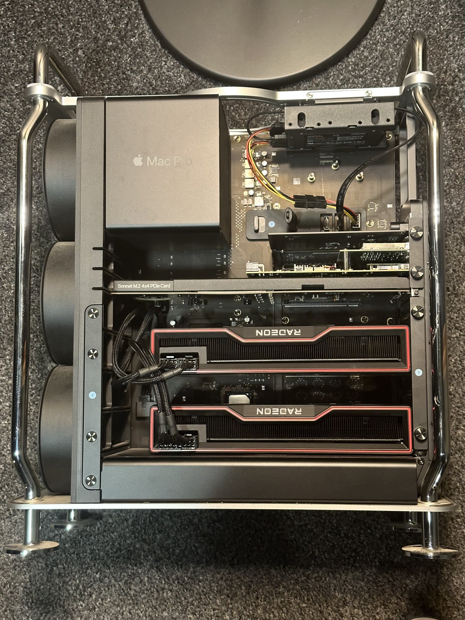

They work straight out of the box. I didn’t install anything or flash anything. These are reference cards. They’ve been working for about 3 years… I think. I ordered them on launch day.
The USB-C doesn’t work on them.
HDMI and DP ports work fine.
My monitors are connected to the top card, while the bottom one is only for computations.
This computer is a color grading workstation, so powerful GPUs are the foundation of this system.
