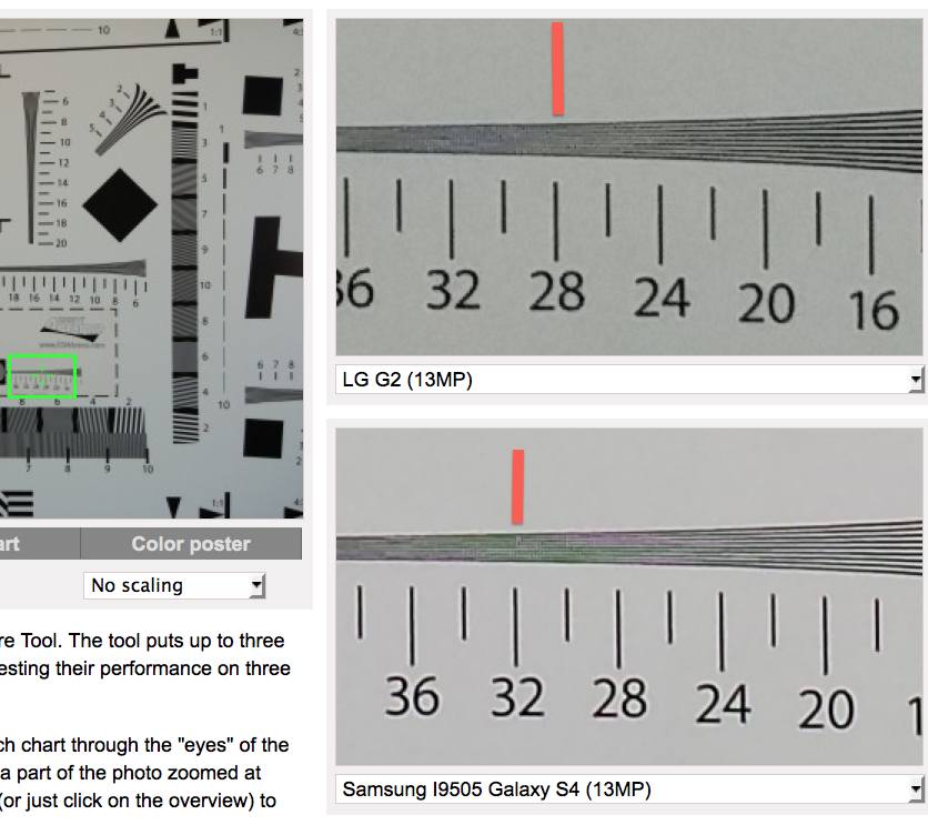

Fortunately, at least effective resolution, is quite easy to be evaluated now, thanks to the extended ISO 12233 tests. (Extended means double-resolution ISO 12233. As opposed to DPReview's double-resolution ISO 12233 image – see http://www.dpreview.com/news/2005/10/14/newreschart -, GSMArena only has a double-resolution area in the lower center of the image, right below the original 1...20 vertical test lines.)
I've uploaded a crop of the GSM Arena double-vertical resolution (10...40, as opposed to the default, abov-mentioned original 1...20) area.
With the LG G2, the near-horizontal lines start to be indistinguisable at around mark 28, while, with the SG4, at around 32. That is, the SG4 delivers considerably higher effective resolution – from the same 13 Mpixel resolution.
HOWEVER! If you consult the SG4 results, you'll see the better effective resolution is definitely the product of he much weaker AA low-pass filter in front of the sensor. As usual with all cameras with (very) weak or non-existing AA filters, there is quite a lot of noise moiré in the image; here, between marks 26 and 36. There's absolutely no color moiré in the G2's shot, thanks to the much stronger AA filter.
I've created a crop showing both the difference of the effective resolution and the moiré. As with most my previous resolution comparison shots, I used a red, vertical line outside the semi-horizontal, original lines to denote the extinction of detail:
(full-quality image: http://www.dpreview.com/forums/thread/3543595?post=52123629&image=0 )

Note that, as I've also explained in my mini-review, the high effective resolution of the S4 is because it lacks a strong AA filter. This is why it has color moire at around the Niquist threshold.
That is, the S4's high effective resolution isn't without problems and drawbacks.

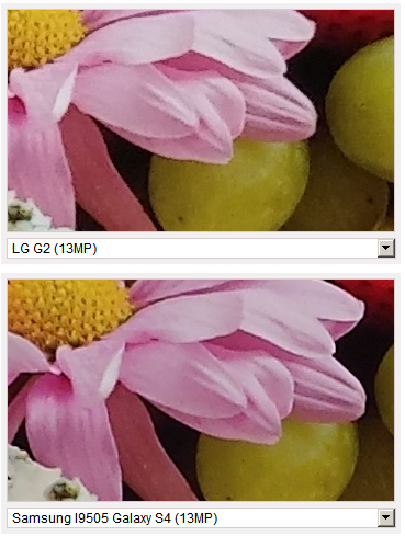

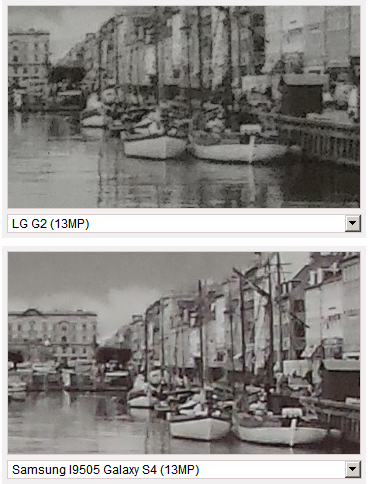

I don't know if I agree with G2 having less noise.
Galaxy S4 has less noise and less artefacts of post processing too.
