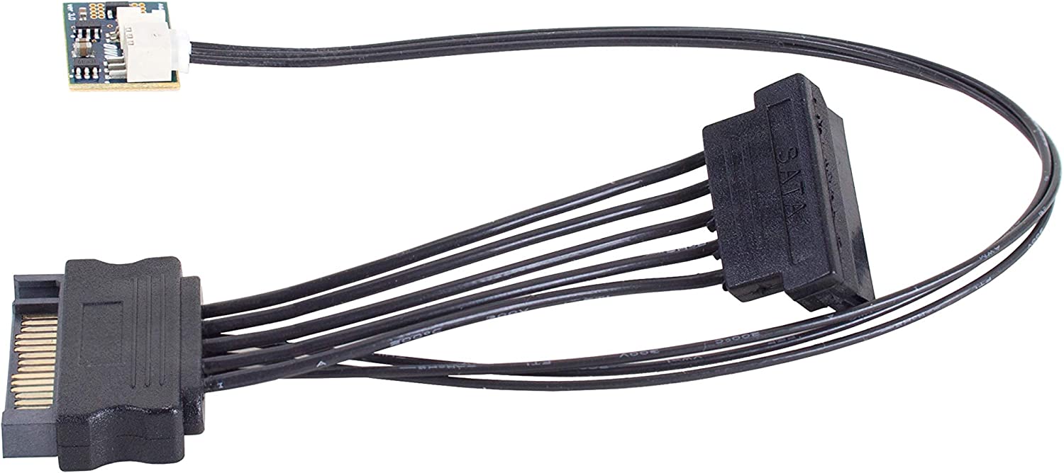

OWC's 500 GB kit is decent at $80. (It's much more expensive here in Canada which is one reason why I didn't get the kit.)

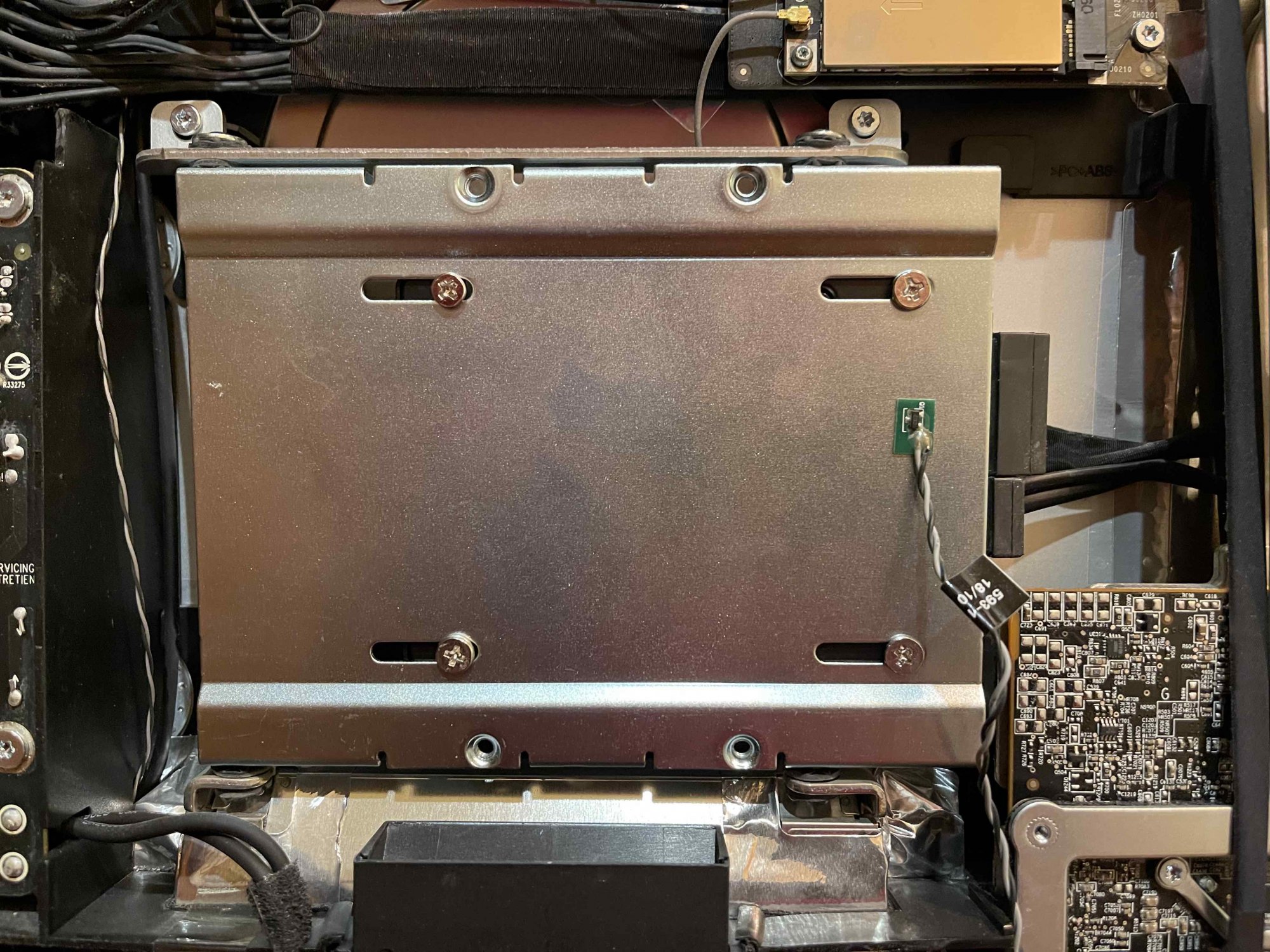

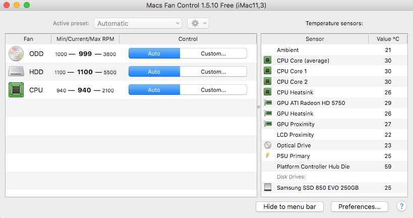

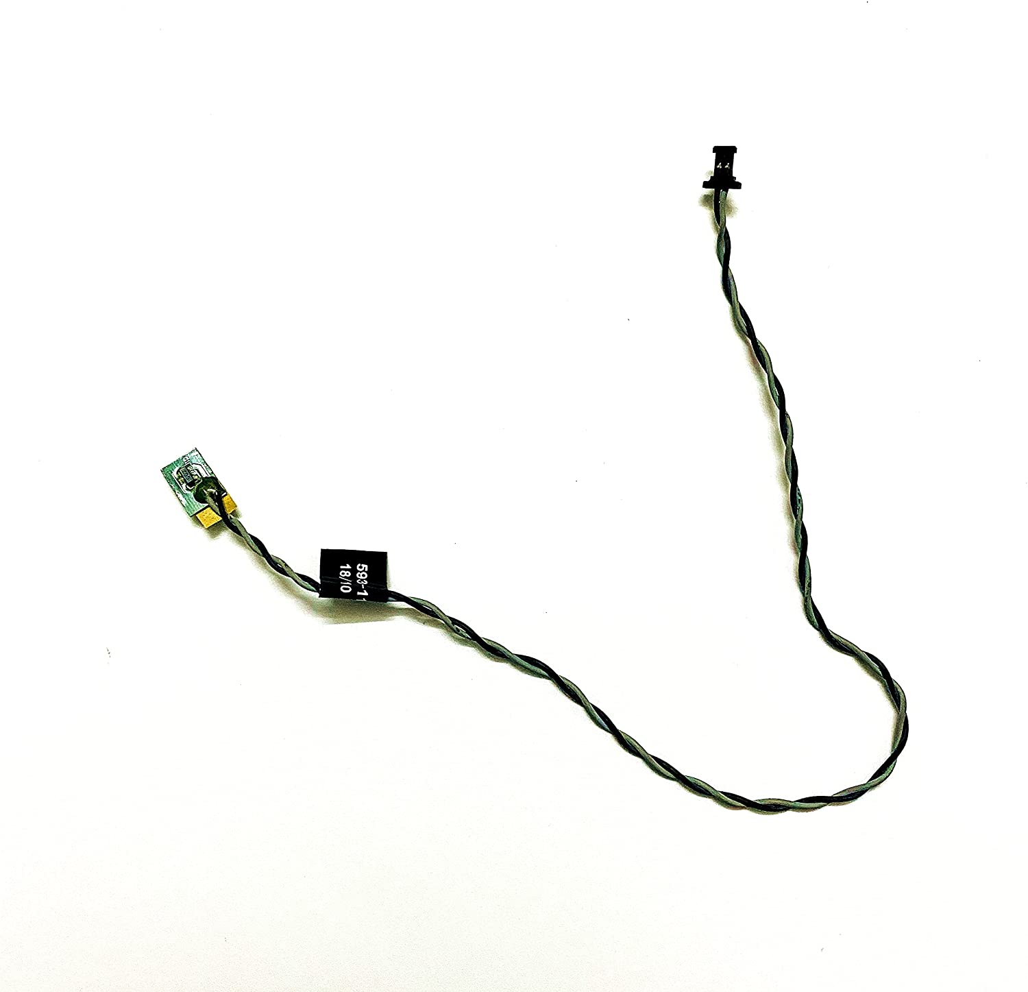

So how is this used? The iMac hard drive has a built-in temperature sensor, and you need to run a cable from that hard drive sensor connector to the motherboard. If you don't, the fans will run at maximum.
OWC's solution is their own custom cable that will provide a temperature reading from a peel-n-stick on sensor that you stick on the SSD, and which also has another connector cable (not pictured) from the sensor that plugs into the motherboard. It used to be something like $50 a while back, but now it's like $15 IIRC.
What I did is buy the optical drive temp sensor cable instead since it's way cheaper in Canada. For the 27" 2009/2010 it's part number 922-9229. For the 21.5" it's a different part number but I think it may just be because the length of the cable.
It has the same connector as hard drive temp sensor cable at the motherboard, but at the other end it also has a peel-n-stick on sensor, that you can just stick on the outside of the SSD for a temp reading. (See bottom right - 250 GB Samsung SSD.)
Actually, I didn't attach it to the SSD. I just attached it to the hard drive bracket, in case I ever want to swap the SSD later.
However, one FREE way around this is simply to leave the hard drive temp sensor plugged into the motherboard, and then cut that cable in the middle and splice the two ends together. That will stop the fans from running at maximum, but you will get no drive temp reading. That's fine though for a low end SSD appropriate for the iMac since it won't run hot enough to matter.

It has been a struggle to get it to slide in place and lock. The screen is black when I turn it on. When I connect to an external monitor it works as expected. I did that as test to try to determine if there was another reason for a black screen. After opening it back up, I could see the cable was not attached. I think if I can get this cable to attach correctly it would be all good.
