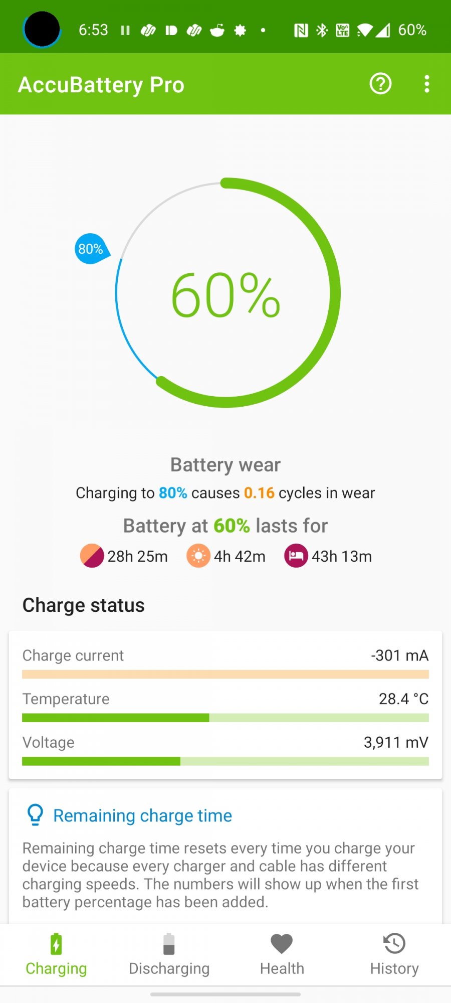

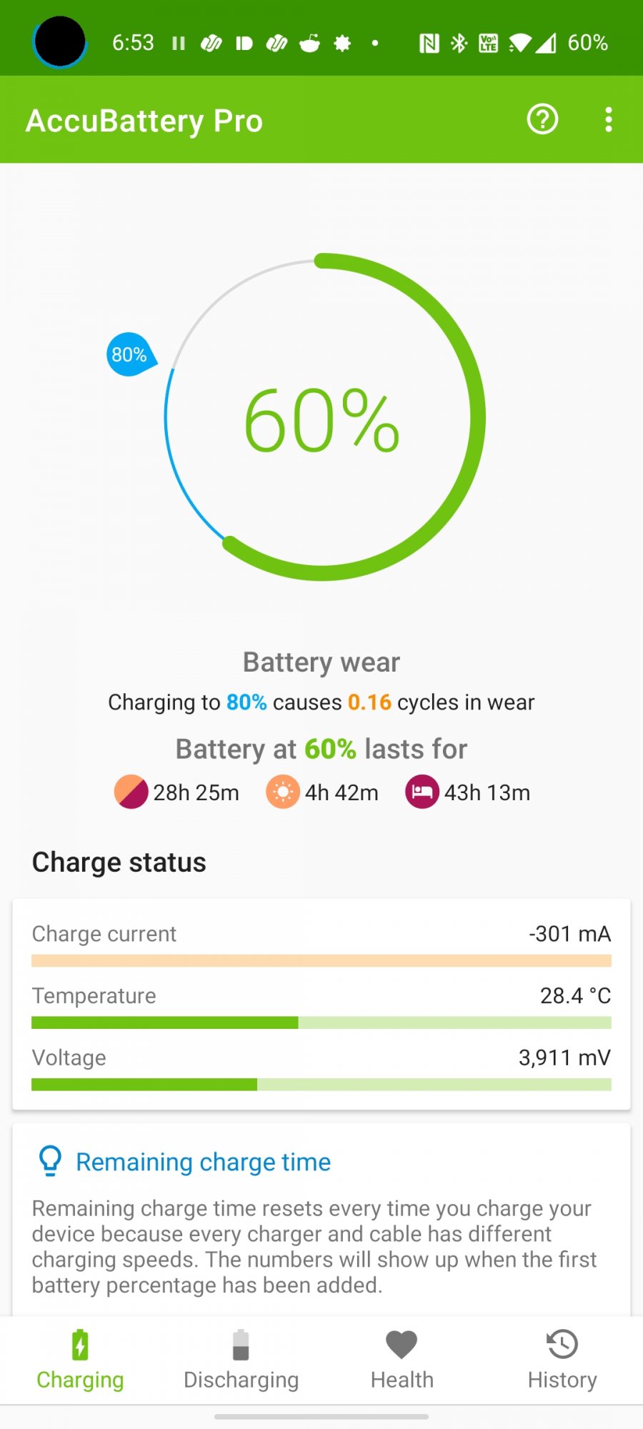

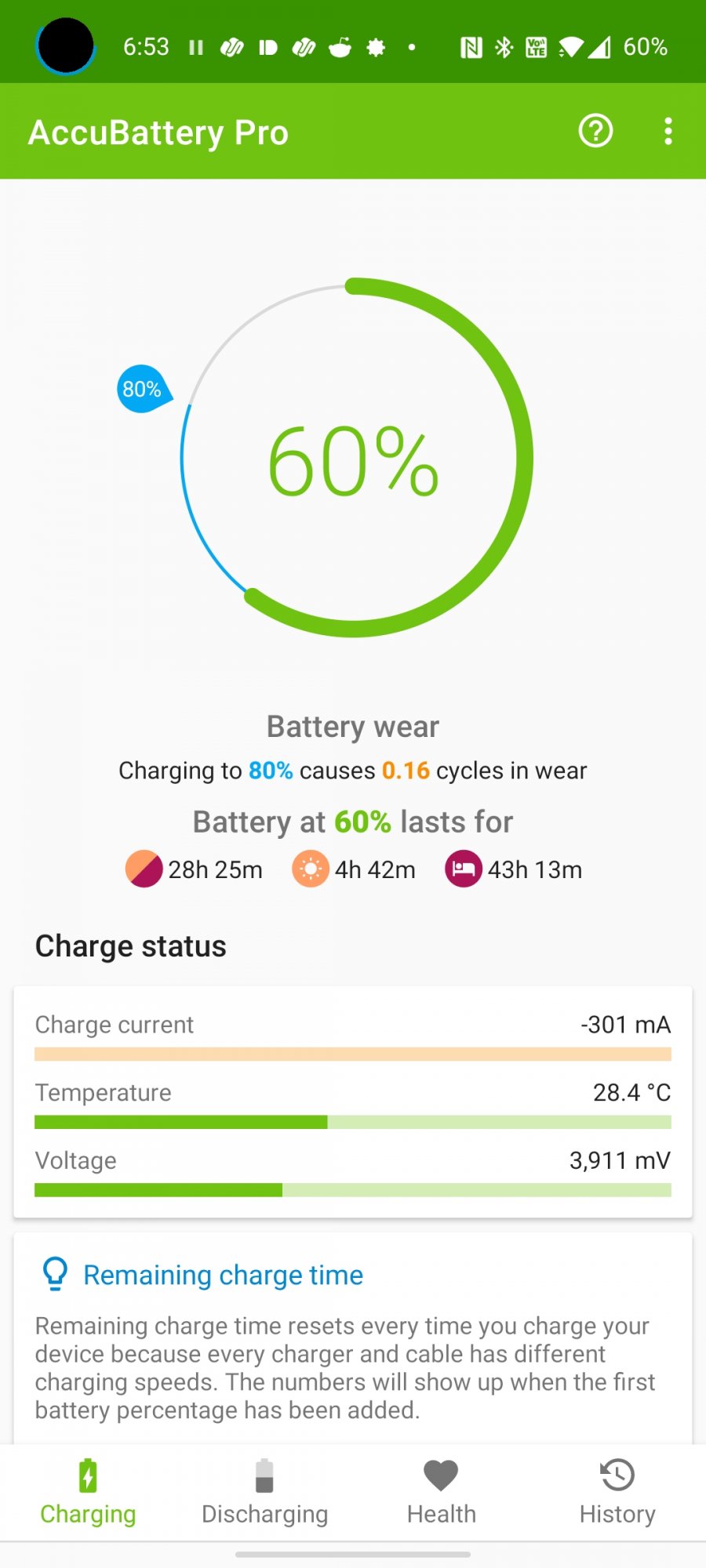

Would this be more along the lines of the sort of thing you would be looking for?
I know it's for Android, but it sounds like the kind of thing you'd want, only for Mac instead.

Would this be more along the lines of the sort of thing you would be looking for? View attachment 1762394
Yes, this would be a lot closer to what I’d be looking for — a utility which would enable you to be able to set how long the battery will charge before either halting re-charge (easier, but simpler) or switching to a trickle re-charge above 80 per cent (more involved, possibly well beyond the limit of what older DC-in board logic would be able to do).
