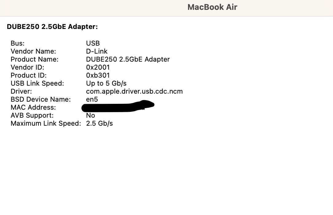

I use this D-Link 2.5 Gbps ethernet adapter. It doesn't use the Realtek chip and is much better on battery.
