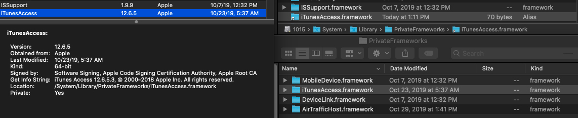

I've noticed that some frameworks related to mobile devices (like MobileDevice.framework) are installed in /Library/Apple/System/Library/PrivateFrameworks/ and have an alias in /System/Library/PrivateFrameworks/ You can try to disable SIP, move iTunesAccess.framework from /System/Library/PrivateFrameworks/ to /Library/Apple/System/Library/PrivateFrameworks/ and create an alias in /System/Library/PrivateFrameworks/.
After disabling SIP, you can run from Terminal
Code:
sudo mount -wu /
sudo ditto /System/Library/PrivateFrameworks/iTunesAccess.framework /Library/Apple/System/Library/PrivateFrameworks/iTunesAccess.framework
sudo rm -rf /System/Library/PrivateFrameworks/iTunesAccess.framework
sudo ln -s /Library/Apple/System/Library/PrivateFrameworks/iTunesAccess.framework /System/Library/PrivateFrameworks/iTunesAccess.framework
Then reboot and re-enable SIP. I've tried with iTunesAccess 12.6.5 and it shows up like this
