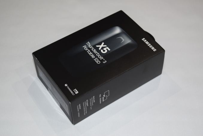

Not a 2017 iMac, but my current boot drive for my Late 2012 iMac is a Samsung X5 Thunderbolt 3 NVMe drive.
I have been happy with it so far.
I have upgraded the X5 drive as it was originally 500GB. I swapped it for a 1TB Samsung 970 EVO Plus NVMe. While the read speeds between the 500GB and 1TB NVMe are basically the same, the write speed was slightly better on the original 500GB NVMe in the X5.
It very fast for my Late 2012 iMac, but since my iMac only has TB1, the X5 is performing much less than what it is capable of.
On your 2017 iMac, it would probably perform more than double than the speeds I am seeing.
It has been stable so far with no issues.

Another thing I forgot to add about the Samsung X5 is that the case looks plastic, but it is actually a big heatsink.
I think that is one reason I was so concerned about how hot it felt at first, but since it is a heatsink, I would expect it to feel hot.
It reminds me of the original Apple TV, the top of it was a huge heatsink and would get really hot.
