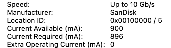

Is the USB-A port supplying power to the SSD? Or does the SSD have a supplementary power connector that powers it?
AFAIK, USB ports still have a limit on how much power they can supply. If a device happens to briefly take more power than the port itself can supply, that can put a glitch on the power lines, and the device might do a reset, or a partial reset. Using the supplementary power jack to supply power virtually eliminates this glitching as a possibility.
You can use System Info to tell you what the max power demands of any USB device is. If it's close to the limit for a port, then you should consider supplementary power.
And yes, it could indeed by a USB-C to USB-A adapter. It could even be any other element in the chain between the SSD and the iMac, such as a flaky cable.

Yes, it's bus-powered, and thus I was wondering about the power issue myself. But since the SSD was idling at the time, isn't that unlikely to be the explanation? There is no supplementary power jack (bus-powered only).
EDIT: Nevermind, the device just also disconneted when plugged into the TB3 port (this was while running a backup, but TB3 supplies 15W, so it shouldn't be a power issue). So it's either a bad cable or that Monterey disconnection issue I read about but thought was fixed. Since I can't delete the thread, I'll edit my original post accordingly.
What's confusing to me is that, even though it's plugged into the TB3 port, it still only registers under the USB section (under Thunderbolt/USB4 it says "No devices connected" for each of the two ports, even though I've got a monitor in one port and this device in the other), and says the available power is only 4.5 W (900 mA @ 5 V):
