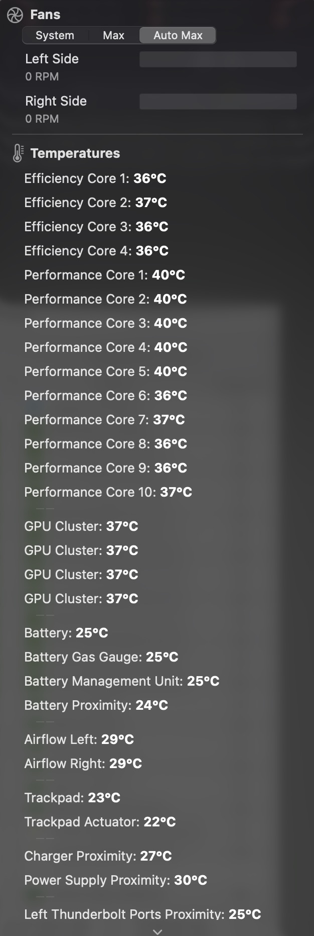

The M4 can easily run up to 100-105C before throttling, so I'm not surprised that your fans are running around 1400RPM at 60C. Right now, the fans in my MBP are off and the SOC temp is at 40C. Even if I turn on Auto Max in TG Pro the fans remain turned off at 40C.

Look, at 60° to 70° the case is just about too hot to touch, like leaving a finger for more than 30 seconds will result in a burn situation. Curious what can explain the same SOC running 20° cooler in the MBP than the mini?

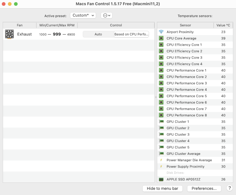

I chose CPU Performance Core 1 for the temperature sensor.
If you can, it would be interesting to see a screenshot to compare:
Also, temp of room is around 70° F (21° C).

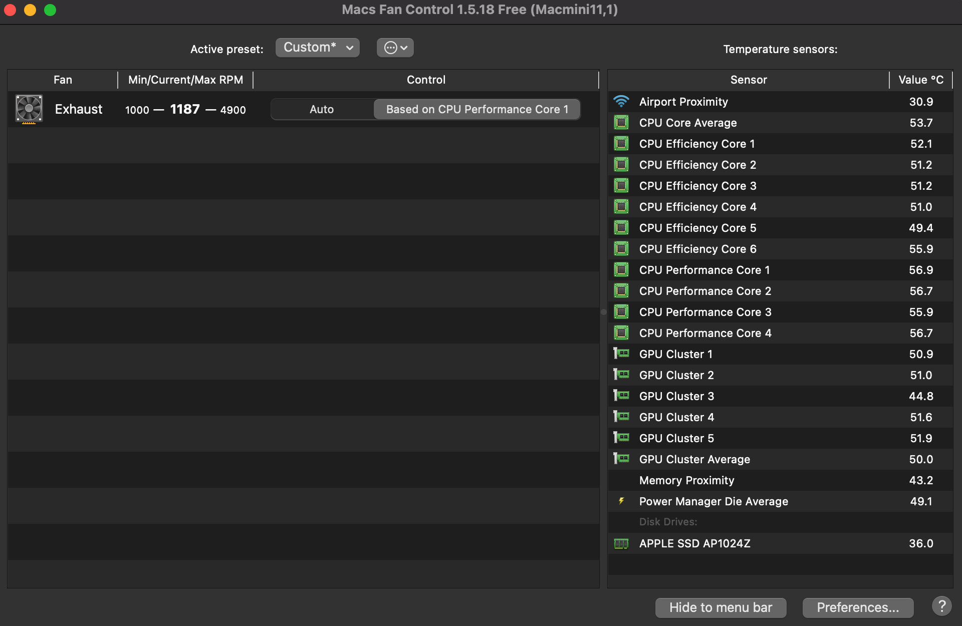

ong ago I mused about using a swamp cooler... I was dissuaded when I forgot it blew very humid air! After living with it and Macs Fan Control, I set on a scenario where I set it to sensor, aiming at the CPU Performance Core 1 and setting it to 50/75. That gets me this (room temp just about 80ºF):
During heavy use (gaming in this case) got most temps into the low 60s with the fan spinning around 3k. Inaudible to me.
