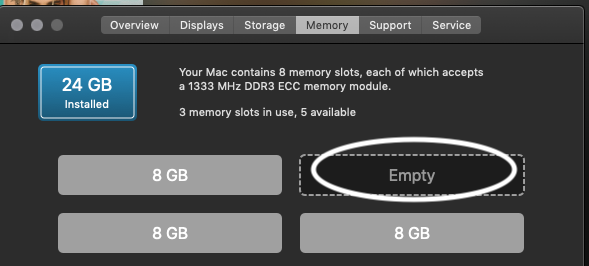

Turned out to be the CPU B Tray not enough tightened

Partial Success upgrading dual 4.1 with stocks CPU to 3.46ghz ones...
ALL GOOD With the processors... delided by myself with the vice method, no problems!
Installed both, and after the startup with side cover removed i noticed a Constant red light lit.
Initialized the system, went to system prefs and noticed that one of the memory was not being recognized.
before upgrading i had all my 4x8gb (total 32gb) memory and slots working.
- already changed the memory on the slot and still the same problem - so it's not the memory ram, it's the slot.
Any help/suggests ?
