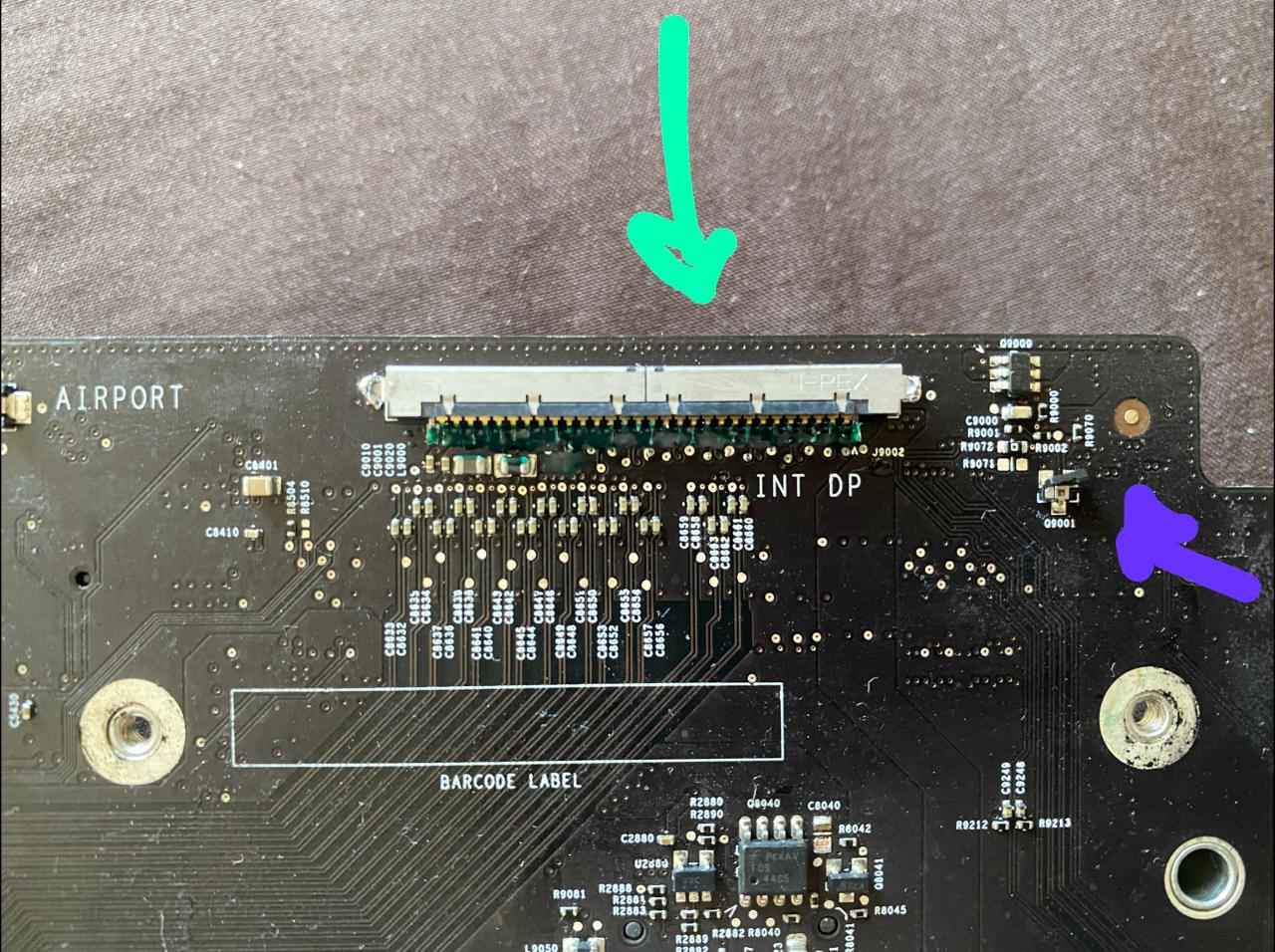

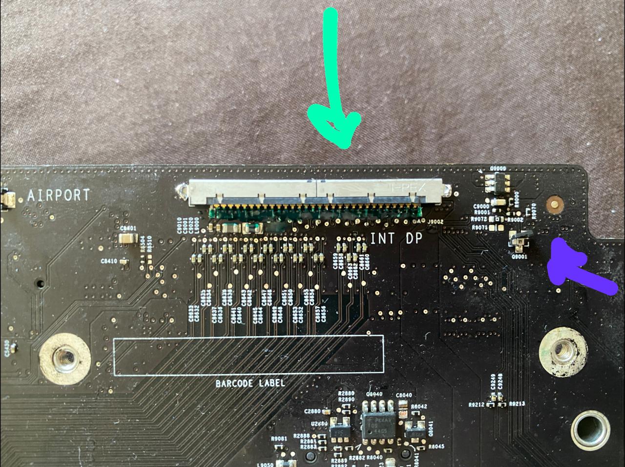

hello I have a screen problem on my 27" iMac from 2009. the screen lights up a bit but I can't see anything on it? does it work on an external screen? I changed the invent card but the problem is still there I tested the screen on another iMac and it works, do you have an idea thank you
On the external screen, check if your iMac recognizes both screens.
If it does, then the issue might be a knocked-off transistor on the logicboard. (If your iMac was opened before to replace the GPU).
Hello, on a 27" iMac the screen stays on a bit but nothing is visible, however it works on an external screen. Could it be from the video card or something else? Thank you for your answer.
